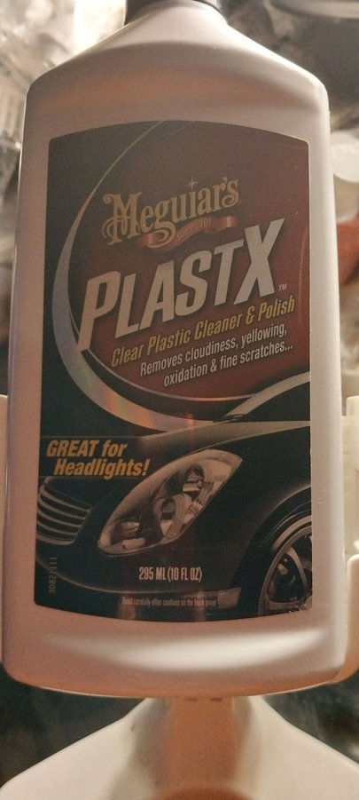

Meguiar's Plast-X Headlight Cleaner And Polish.
Old Mar 25, 2025 | 08:17 PM
Chitown Fit's Avatar
Joined: Jan 2015
Posts: 1,034
From: Chicago
Just polish on and wipe off.
No need for and sanding or intensive scrubbing needed.
Great for keeping your headlight lens from clouding up.
If your headlight lens is already dull and cloudy, this product won't miraculously shine and clean your headlight lens.
It's good as a preventative way to keep your headlight lens from getting dull and cloudy.
I clean my headlight lenses with every oil change.
Available at your local Autozone.

Meguiar's Plast-X Headlight Cleaner.
Originally Posted by Mister Coffee
@Chitown Fit You have exquisite timing, Chi. I was just noticing my slightly foggy headlight lenses. Thanks.
Thanks..
My headlight lenses on my 2015 EX are still clear.
I just buff my headlight lenses after I change my oil.
It's more of a preventative measure to keep my headlight lenses clear and cloud free.

I have used this in the past. But it didn't last an entire year. Had to do them again and again and again.
Found out that other products work better and last around 3 years.
Last few times I did the headlights, I used this:
