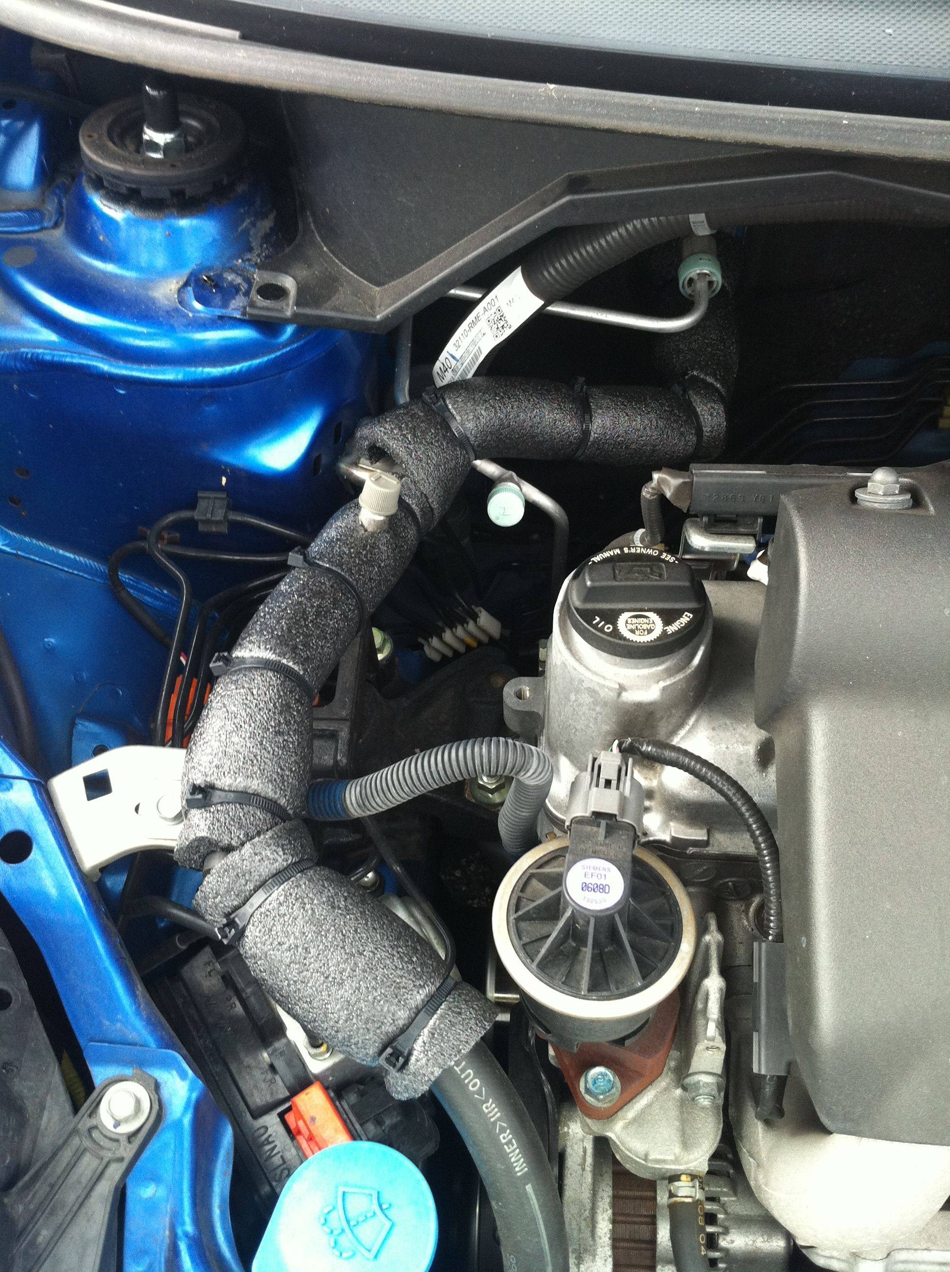

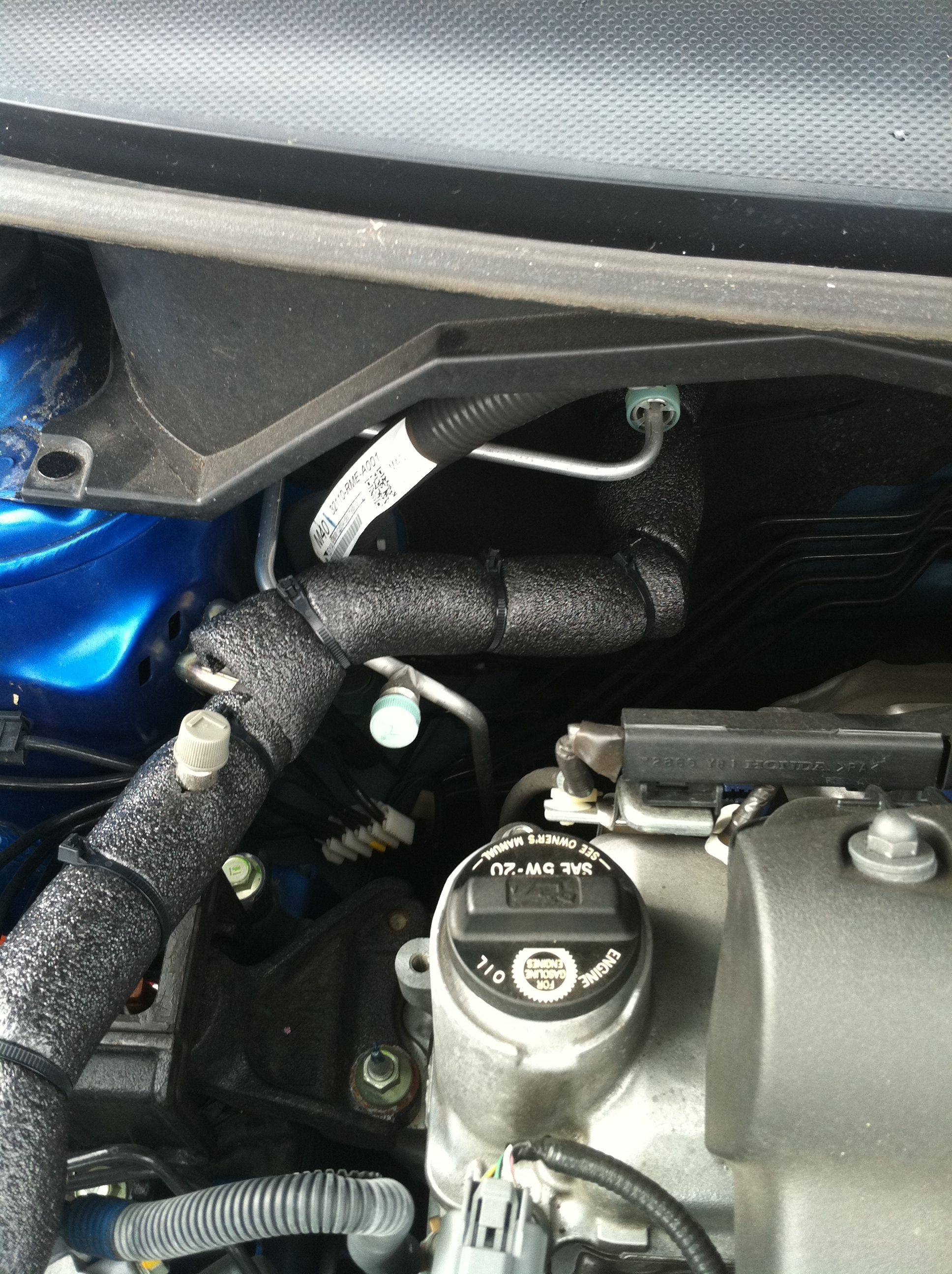

I insulated the LP ac line total cost $2 and i notice a big difference in the south florida heat.

Do I have to crawl under the car to do that? Where is this LP ac line? Instructions please? (Make it specific, I am a girl)

no you dont even get your hands dirty.
I used 1/2 inch pipe insulation from lowe's .99 cents for 6 feet and about ten 8 inch black zip ties.

I like that tip about insulating the line.

That's a good idea. I'm gonna try that this summer, see if it helps with the NW Indiana heat, too.
