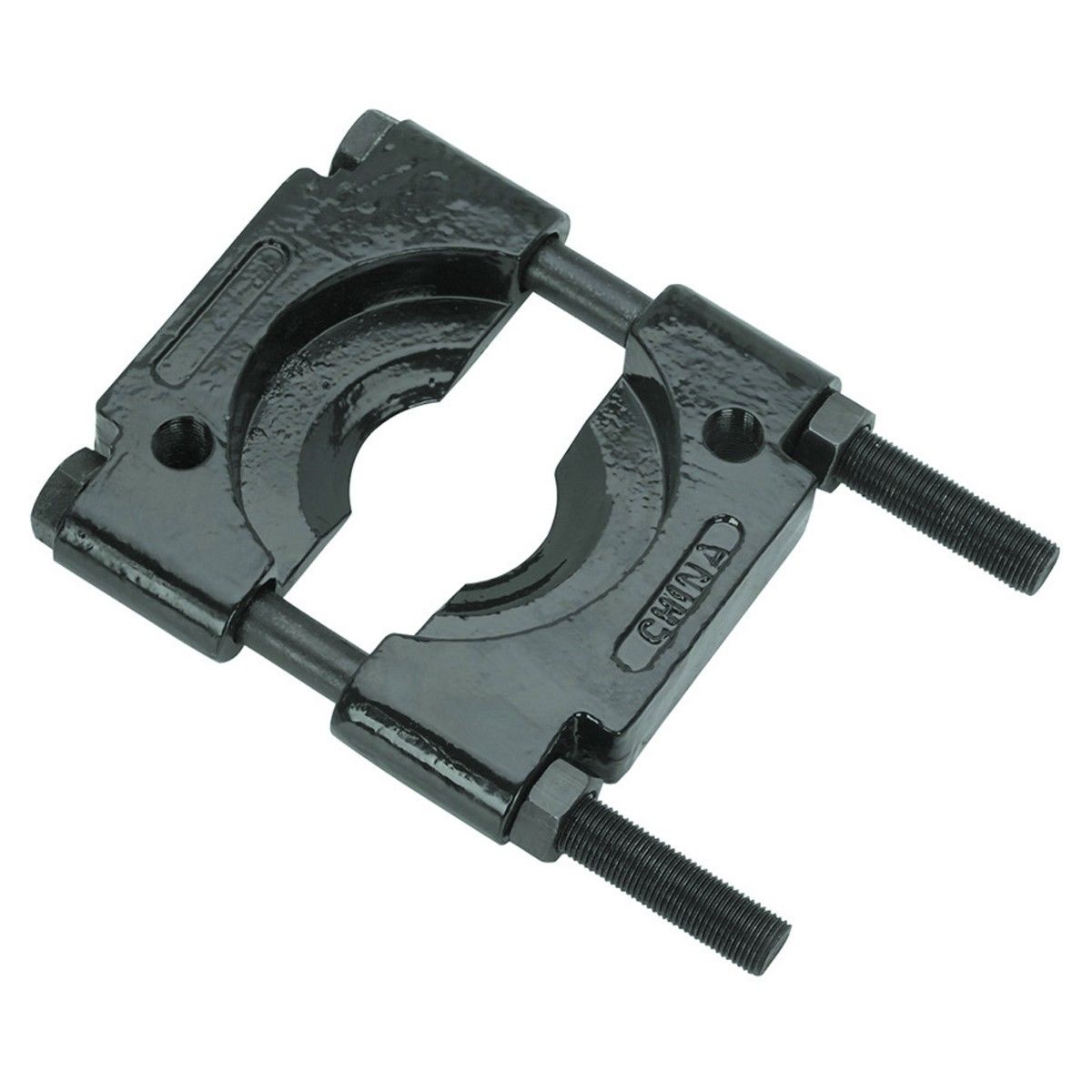

On 07 you need to change the bearing by pressing it out of the steering knuckle.
to do this you need at least 20 ton hydraulic press and heavy duty bearing 1.5 to 2" range bearing splitter (to remove inner half race that typically sticks to the hub)
If any part of the bearing is rusted to the hub or knuckle the replacement will become a huge exercise. Most aftermarket bearings are reported to fail within 2 years; genuine bearing is expensive.
the best solution in this case is to install used low mileage steering knuckle assembly; the used hub should rotate smoothly (like "a spoon in the heavy motor oil"
) without binding , clicking, etc
