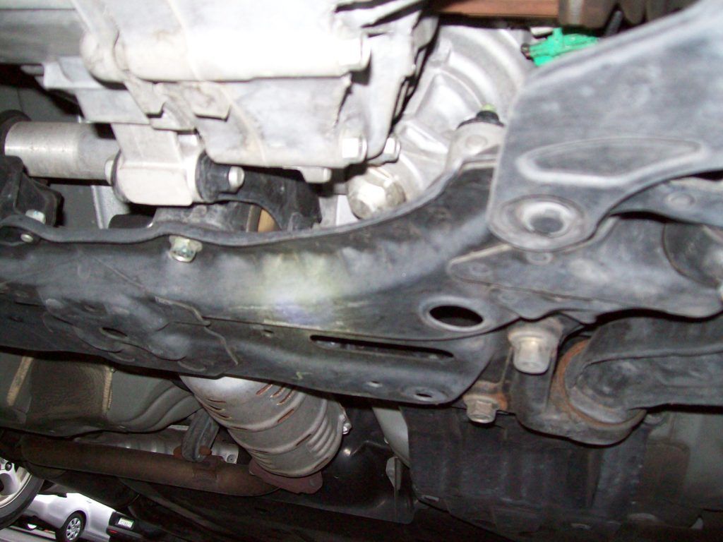

Lifting pad on X-member

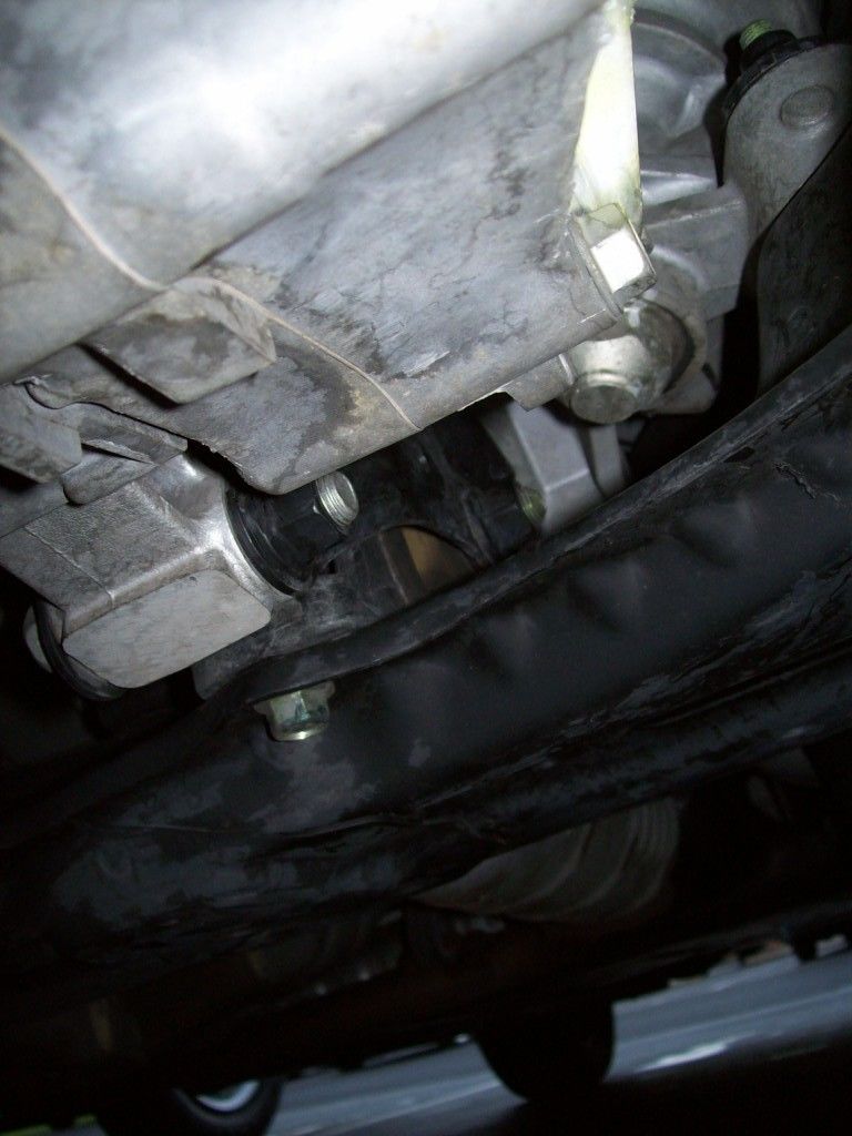

Old mount. The split is covered by side plate
Front mount to X-member bolt (14 mm)

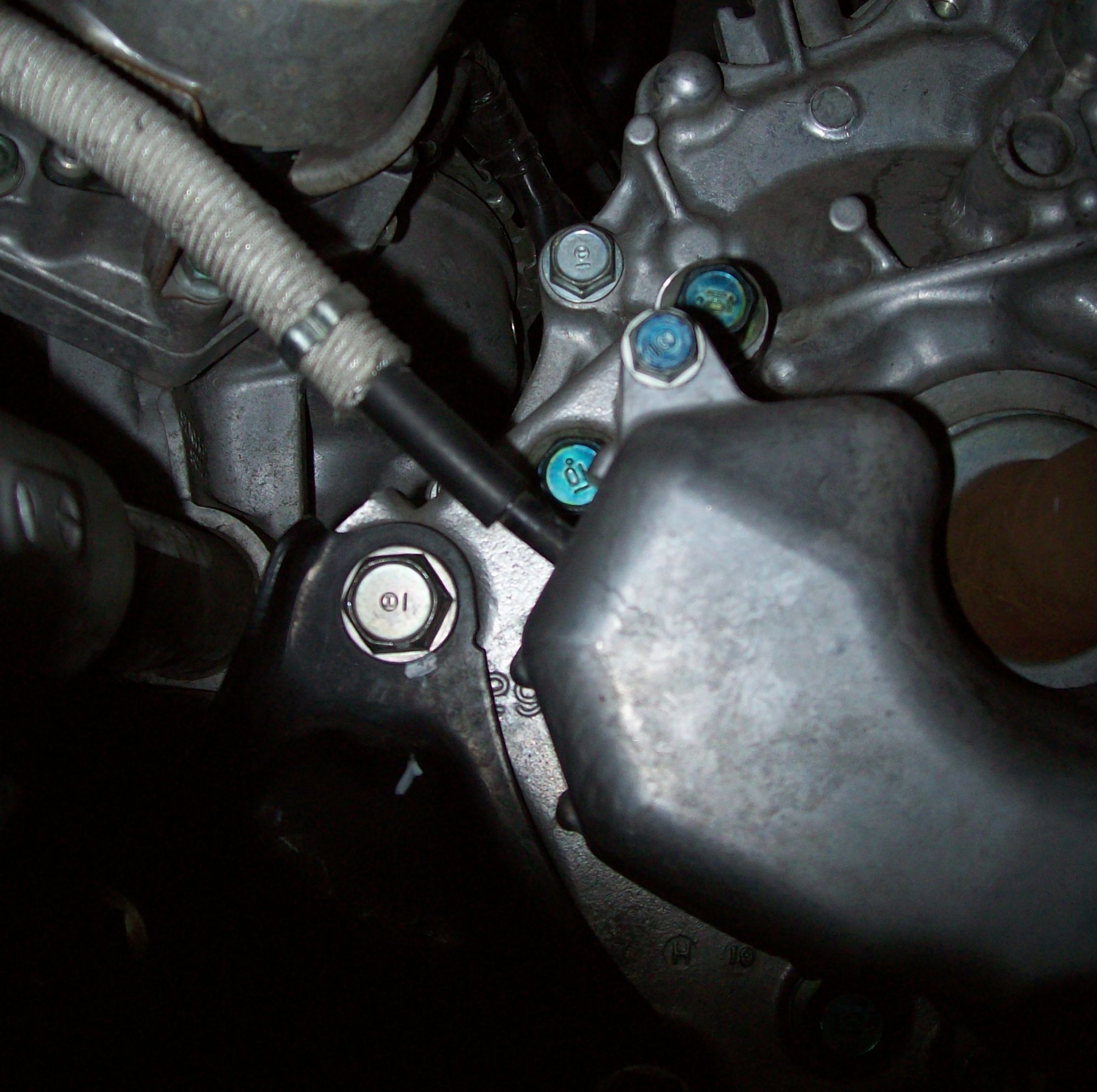

Upper side plate to transaxle bolt (17 mm)
Removal of vibration canceling block makes access to the rear bolts easier

I use marker to outline an original location and a car tire changing jack to adjust the height of the transaxle housing. Once marking lines up can snag the bolts
