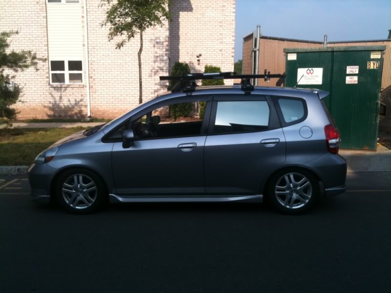

this is how it sits now the other side needs another 1/2 inch from the other spring.

Old May 27, 2011 | 11:16 AM
GD3_Wagoon's Avatar
Posts: 5,244
From: eightONEeight
try putting the rear on jackstands and rotating the clunking spring till it settles into the perch. i had the same problem with my pro-c's and that was my fix.
also check to see if it's not just your spare tire, scissor jack, or tire iron moving around in the spare tire well. i had that problem too and only realized it after tinkering around with the suspension for almost an hour ..
