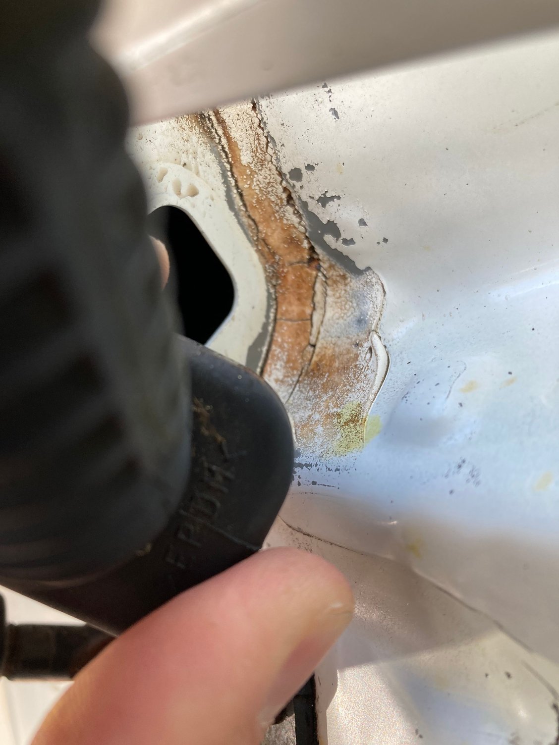

Just a follow up if anyone is having the same issue in the future. I started by removing the front door panel to see if there were any leak coming from there. I read that a lot of Fit were having this issue with a plastic film not properly sealed inside the door. Mine was fine.
Second I checked the roof gutter since a lot of Fit have a problem with this seam cracking at the back. I'm now pretty sure it's coming from this gutter but at the front, leaking in the pillar beside the windshield and finding a way into the drive side. The metal part of the hood latch release handle is rusted too. I'm going to remove the plastic cover to check underneath it and report back here. If it's really a roof leak I'm planning on putting some transparent Amazing GOOP automotive adhesive. Supposed to be flexible, waterproof, flexible and paintable.
Thanks for the update! Definitely let us know if you track down the actual cause.
I've had the driver side floor wet once as well but it seems to have stopped since I re-sealed the welds in the gutter in the rear (just near the hatch). I don't know if it's related or I was just lucky. The other potential issues (door, gutter in the front) is what I've seen mentioned but didn't need to touch myself so far.

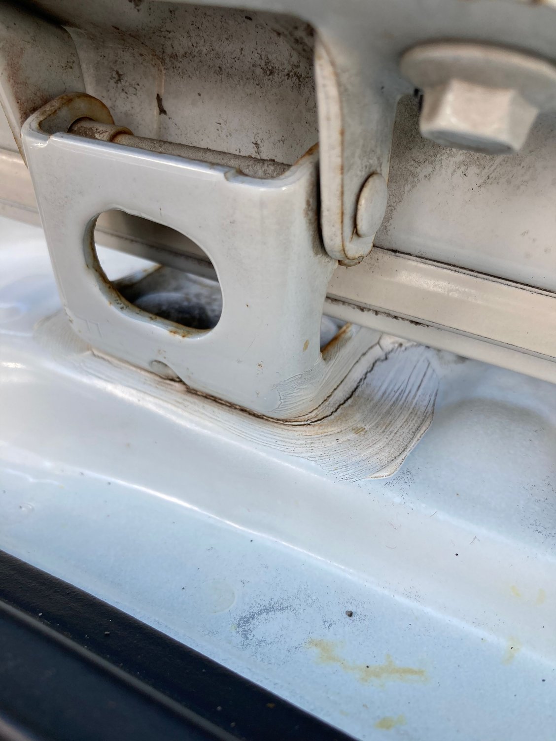

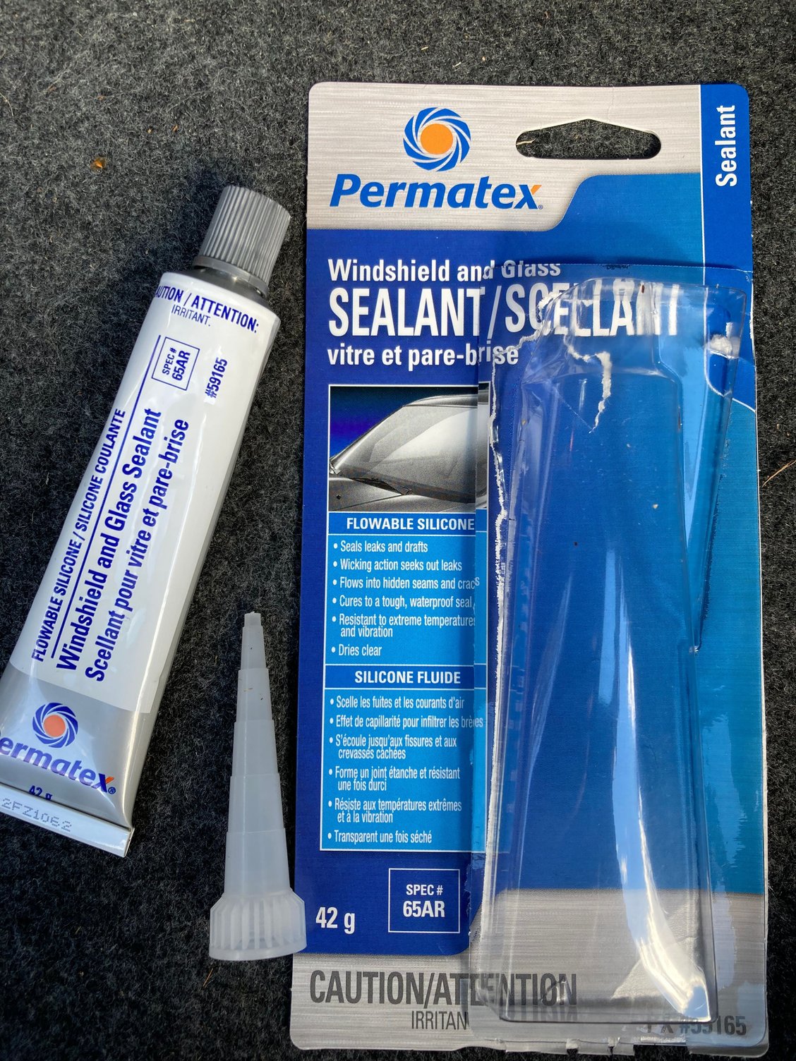

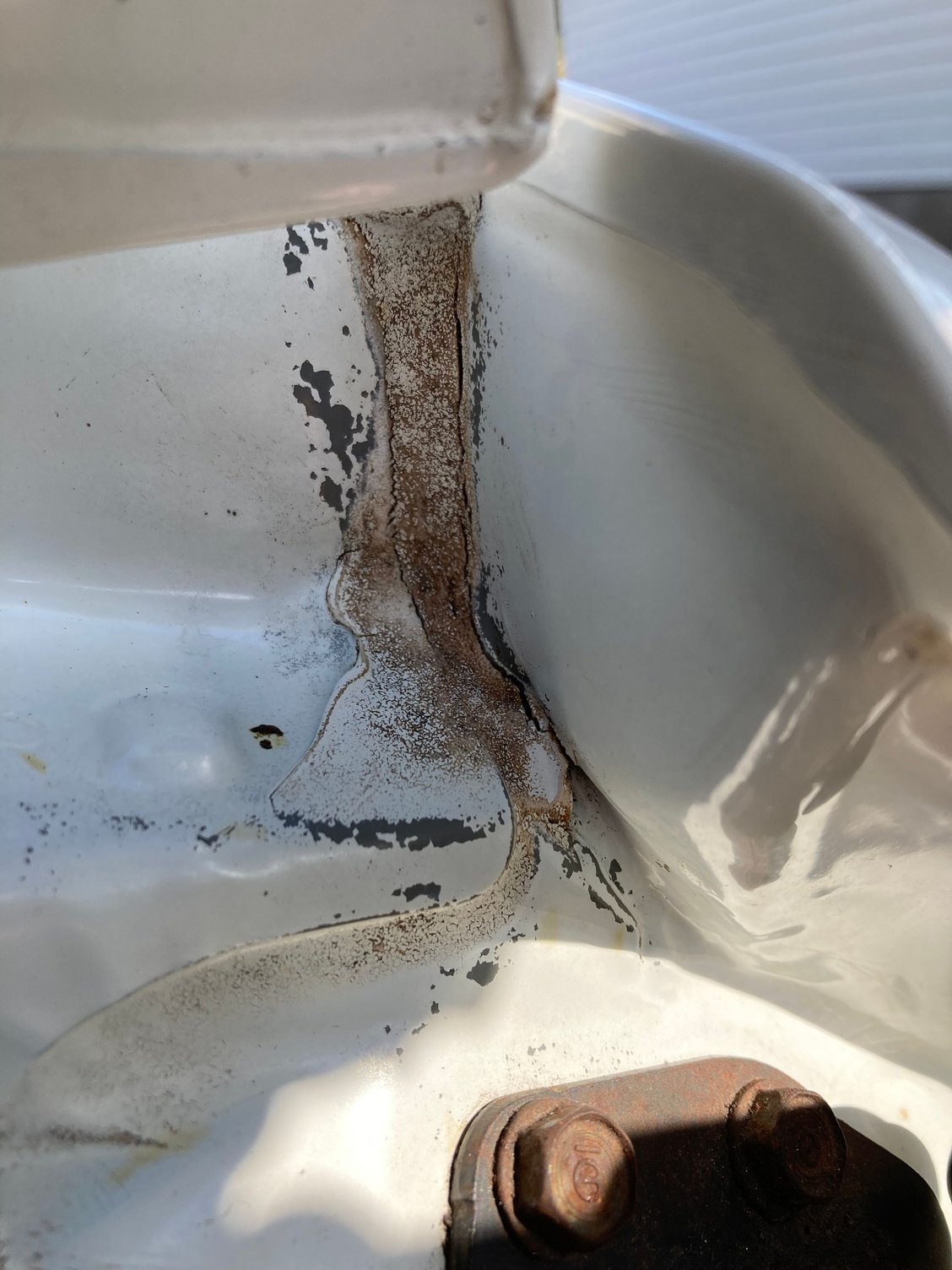

I took the time to clean the gutters today before re-sealing the welds with Permatex windshield sealant. It’s flowable so it’s supposed to go inside the cracks.
They were cracks at the front and at the back but also around the hatch hinges. I also removed the cowl at the front, removed the dirt with a vacuum and a brush to see if there was a leak coming from that part but everything seems ok, no apparent crack, no rust or no damaged grommet.
So it’s definitely not coming from the door or the firewall. Must be the cracks at the front. I’m going to let the sealant cure for 24h and I’ll do a test with my hose. I still got to remove the rust under the carpet, prime and paint the floorboard.
