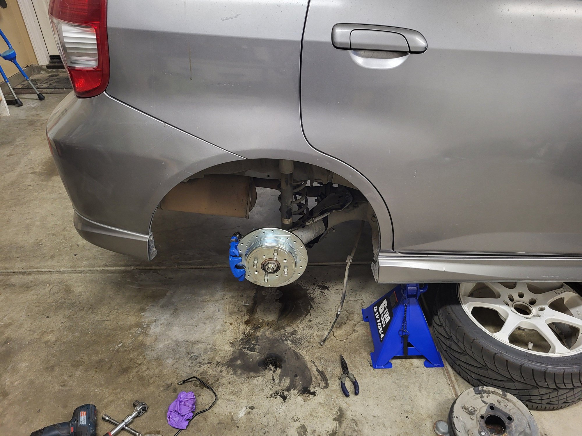

I have a 07 Fit as well and one of the first things I did over 10 years ago was change my front rotors. I changed them to slotted and changed the pads to performance pads. I did this because my brakes were heating up pretty bad driving the mountain roads in the area I live. I found a noticeable difference in my braking. Recently "due to boredom" I changed the rear drums to disc, there is a how-to on FitFreak. I bought the bracket on ebay and the rotors from rockauto. I bought the rotors for a 99 integra and I went to a wrecking yard and got rear Calipers off of a 99 integra. I got the parking brake cable off of a 89 acura legend. It was tedious to get the job done but I am thrilled with the results. I feel like my FIT can stop on a dime.
