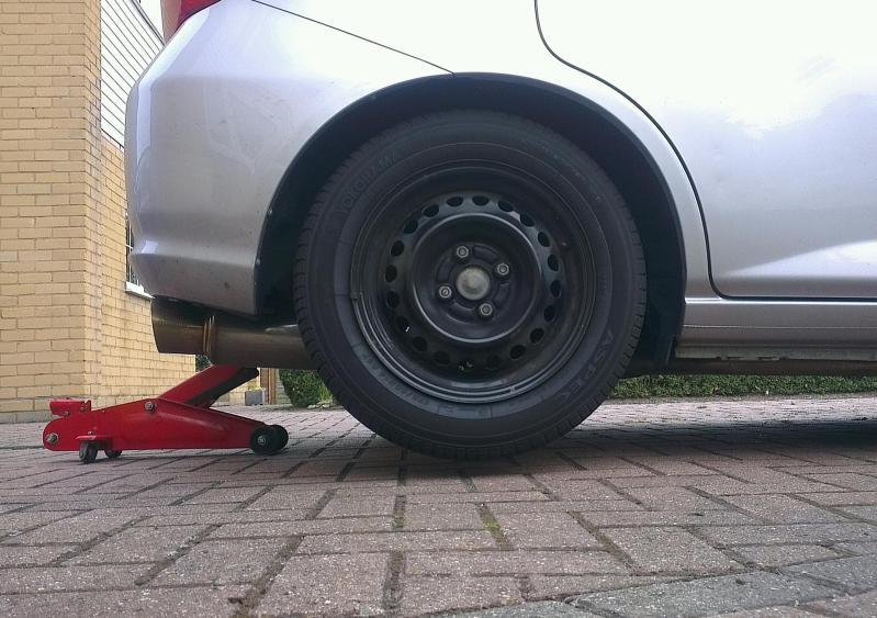

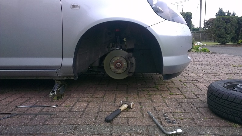

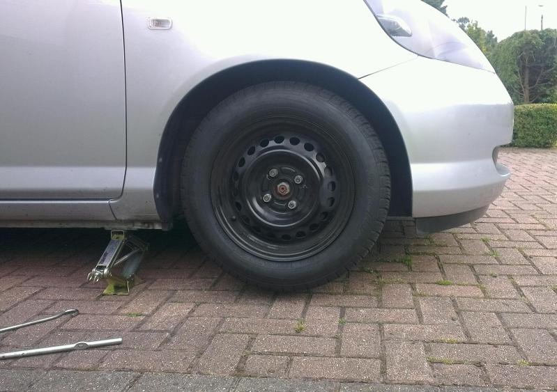

I've finished tweaking the ride height, pre-load and damping. Also had the front geometry set up to my liking.
The new set-up is great. Firm but comfortable. Loving the BC Racing coilovers...
It's also good that i don't need to jack it a mile off the ground to change wheels, lol.
Next on my list is to get the front and rear arches rolled/pulled to allow me to refit my 7"x15" ET30 RB's.
Can't wait to get them back on.

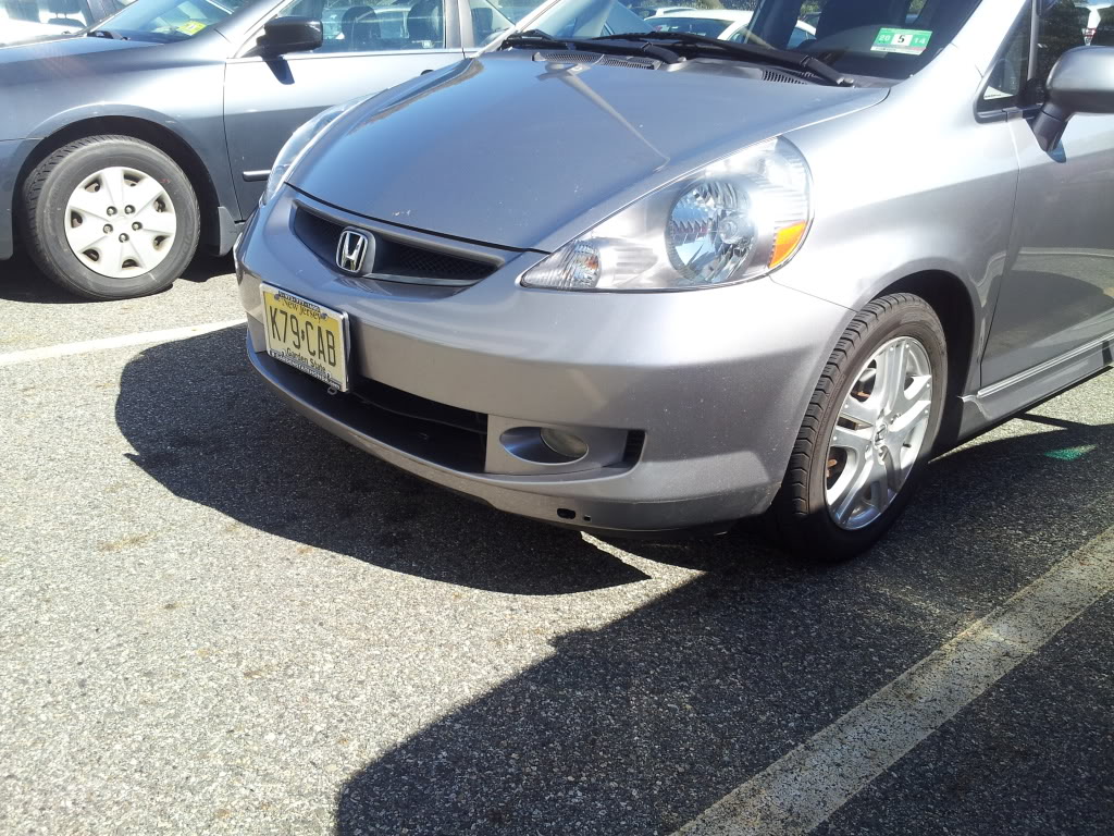

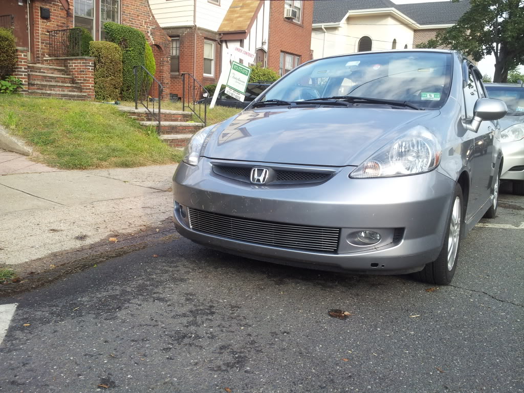

Front lip delete (broken, don't want to pay to replace):

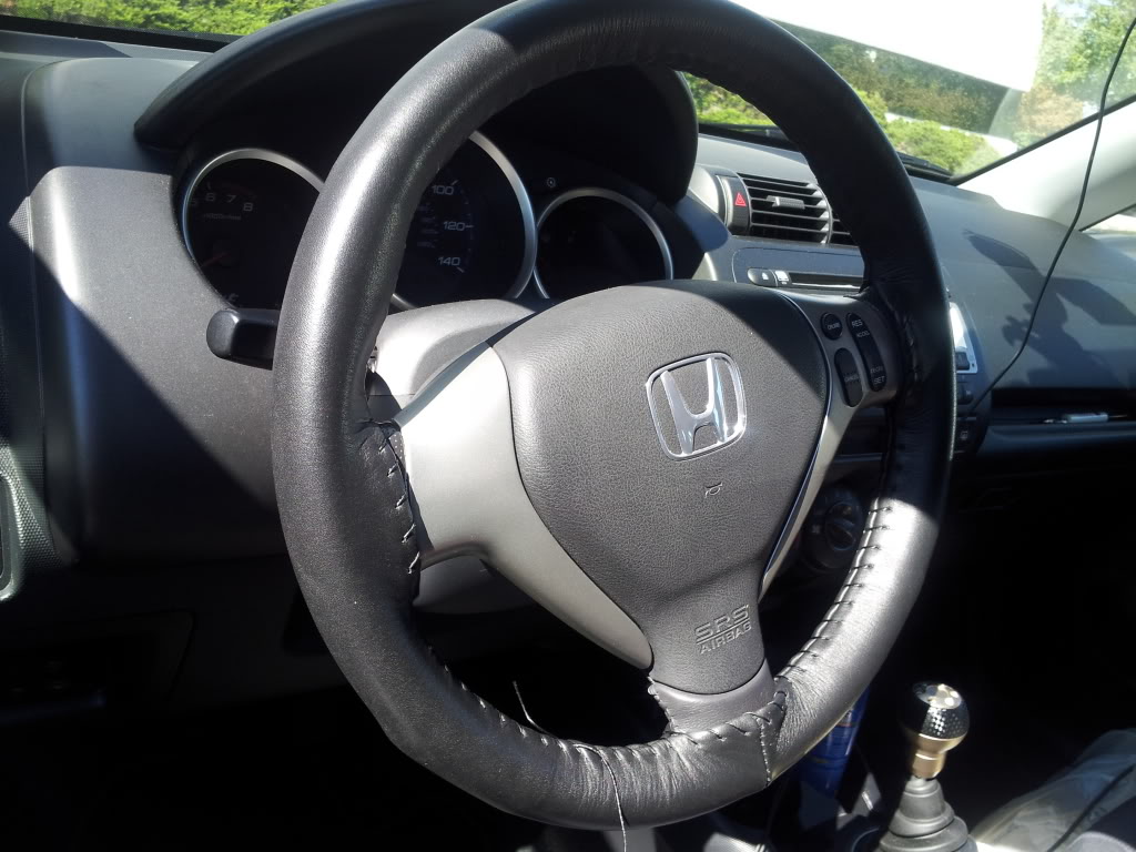

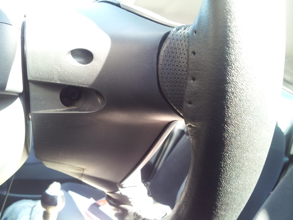

Wheelskin (need to trim cord):

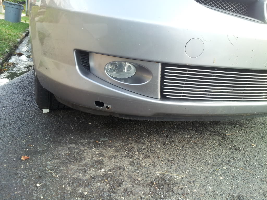

My 07 Sport's PO cracked the front lip and smashed the front grille (in front of the AC condenser), so I pulled the lip (I'm too cheap to replace), and replaced the grille with an ebay billet grille. I must say, the grille looks pretty awesome.
I wanted to do a full writeup, but I was up against a religious festival I had to finish before, and then a hailstorm broke out in the middle of the job (seriously). So, only after pics for your enjoyment.
The grille went on easy enough, but the instrux were ambiguous. Best I could figure, it had four Z-shaped hooks which screwed into the back of the grille, and which were supposed to hook onto... something. They seemed to match up with the slots in the bumper cover where the factory grille locked in, so I hooked them in there. Which wasn't the greatest, since the bump that cracked the factory grille also damaged the slots. The bumper cover is slightly distorted where the hooks pull on it, but it's not noticeable from outside the car. EDIT: oops, I guess it is a bit visible. C'est la vie.
The tricky part was mounting the fog lights. They screw into the edges of the factory grille, so I used tin snips to cannibalize it, and reinstalled the sides in the outermost tabs. The lights were then ready to install. (Sorry for no pics here.)
Now I just have to figure out how to mount the license plate, since the factory bracket bolts through the front grille, but it no longer fits.
Before
After

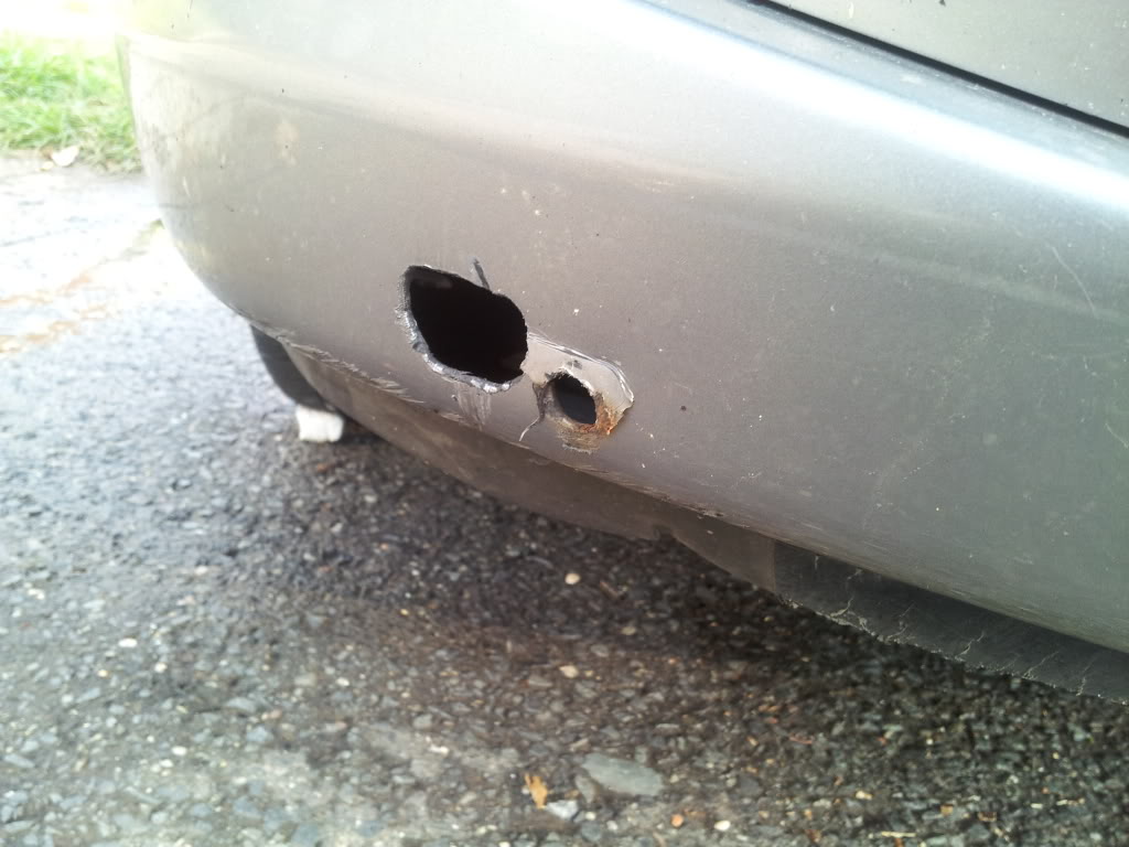

Crack where the front lip bolt got pulled through
