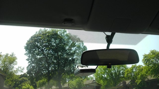

Day 3:
I had the day off, so I took this opportunity to hardwire install my radar detector.
I haven't checked if there's a decent DIY on this forum or not, if it would be helpful I can create a thread for this to help others... It's super simple.

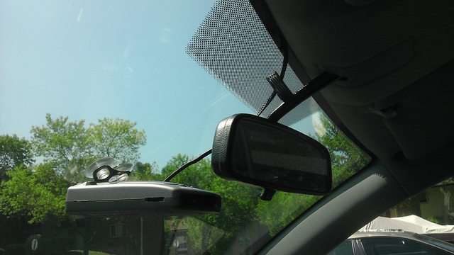

The first thing I did was run the cable from my detector (Escort Passport 8500) through the handy guide hole in the rear view mirror brace, and up under the head board. Sorry I don't have pics of this process, I wasn't thinking about it at the time. Just take a credit card and gently push the cable up under the panel.

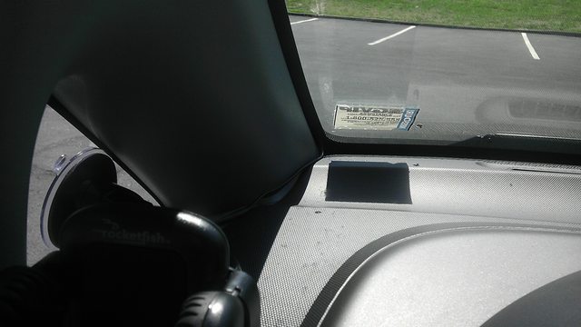

I guided the cable over to the driver side A pillar and again tucked it behind the panel. When I reached the dash, pulled the cable tight-ish and began running it under the foam door molding.

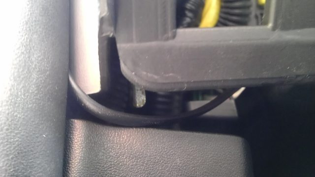

This leaves very little cable exposed, and definitely looks better than having a big assed exposed cig outlet charger.

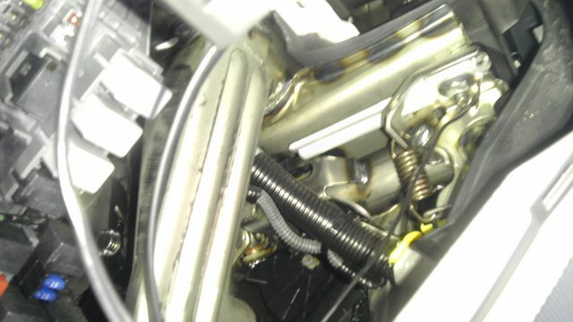

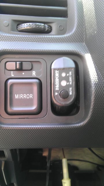

Next I ran the cable up under the panel below the fuse box (not through the actual fuse box access door).
I popped the cover panel out from behind next to the mirror adjustment controls and hid the mute switch here, securing it with some velcro. This worked out nicely for the Passport's mute switch, however other brands may or may not fit well. Either way, this is a very discrete, easy to reach spot to hide the mute switch.

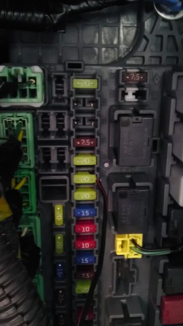

Now we get to the fun part. Be sure your car is turned off, keys are out of the ignition, and you may want to disconnect your battery (I didn't but others may advise it). I piggybacked off of the rear power window circuit since it comes on with aux power, and I won't be using them that often. The line its self has its own fuse so using an add-a-circuit wasn't completely necessary, but you could also go this route for a cleaner install.

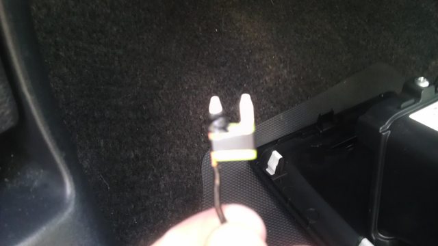

I pulled the fuse and carefully wound the positive lead to one of the posts, and secured it with electrical tape. This will be compressed pretty tightly once you re-install the fuse, so it won't come loose, but he sure you don't have too much bulk or it wont fit. I had this setup on my previous car for four years without issue.
It should fit back in place with slightly more effort than usual, but you shouldn't be jamming it in. It will fit flush with the rest of the fuses. Now we need to ground the system.

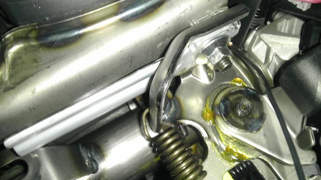

It may be a little difficult to see from these pictures, but up and to the right there's a bolt that connects to the frame. I loosened this a few turns so there was some clearance between the collar of the bolt and the frame. Next I exposed about an inch of copper on the ground lead, and bent it into a hook shape. The hook went between the frame and the bolt, and the bolt was cranked good and tight over it, keeping it secure.
Next I popped the key in, fired the car up and tested the windows. The detector comes on with aux power just as expected.

Wow, day 3 and you're already all over that thing... I like the way the mute remote fits right in that spare slot. Nice!
I have an 8500 also but I don't have your patience and besides I swap it around with other cars I drive.
