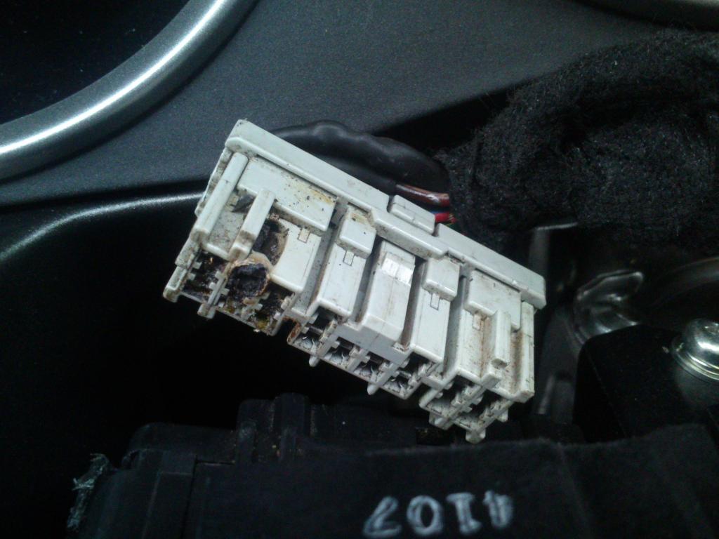

Old Jan 1, 2015 | 03:14 PM
  #50
Mapone's Avatar
Posts: 34
From: Czech Republic
Today it happened to me. During a long time driving I felt something like burn plastic. I turned the lights OFF and from that moment I can't turn the headlights ON. Only parking light and high beam are working...
I disconnected the connector under steering column cover and found this.
Size:  78.7 KB Now I see I'm not only one with this issue...
