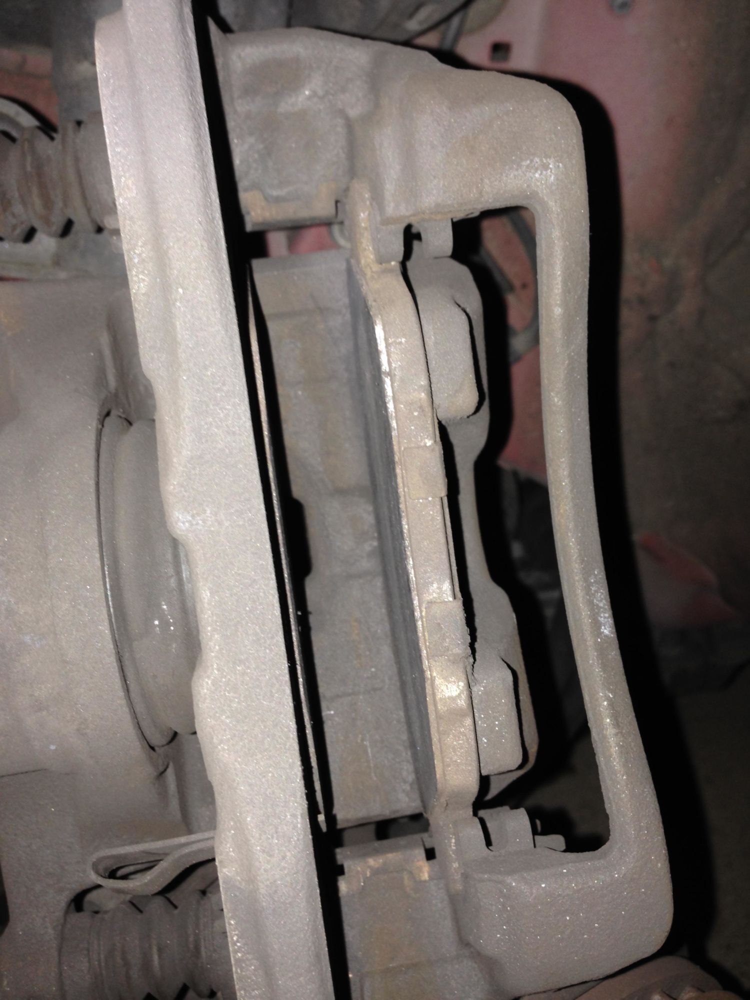

It was the brakes... I had assumed break noise would be consistent in forwards and reverse, but who knows. Here's a pick of the old pads, the rotors didn't feel too awful... I'll inspect the shoes/drums later in the week to make sure the adjustments right. I feel like I just did the breaks.... but we put a lot more miles on the car then I think and the calibers have jammed a few times - burning through pads (I've since rebuilt them) so I don't by the high end pads.... anyways.
Thanks for the advice!!!!
These might be at the end of their life:
They still have 50 miles...

That picture...
Old Mar 3, 2016 | 09:22 AM
geopat's Avatar
Joined: May 2014
Posts: 205
From: burlington, ON
Holy crap those should have been replaced last year

Had same thing fixed on 2008 Accord. When wear sensor is at the BOTTOM position, then noise will be present at reverse
