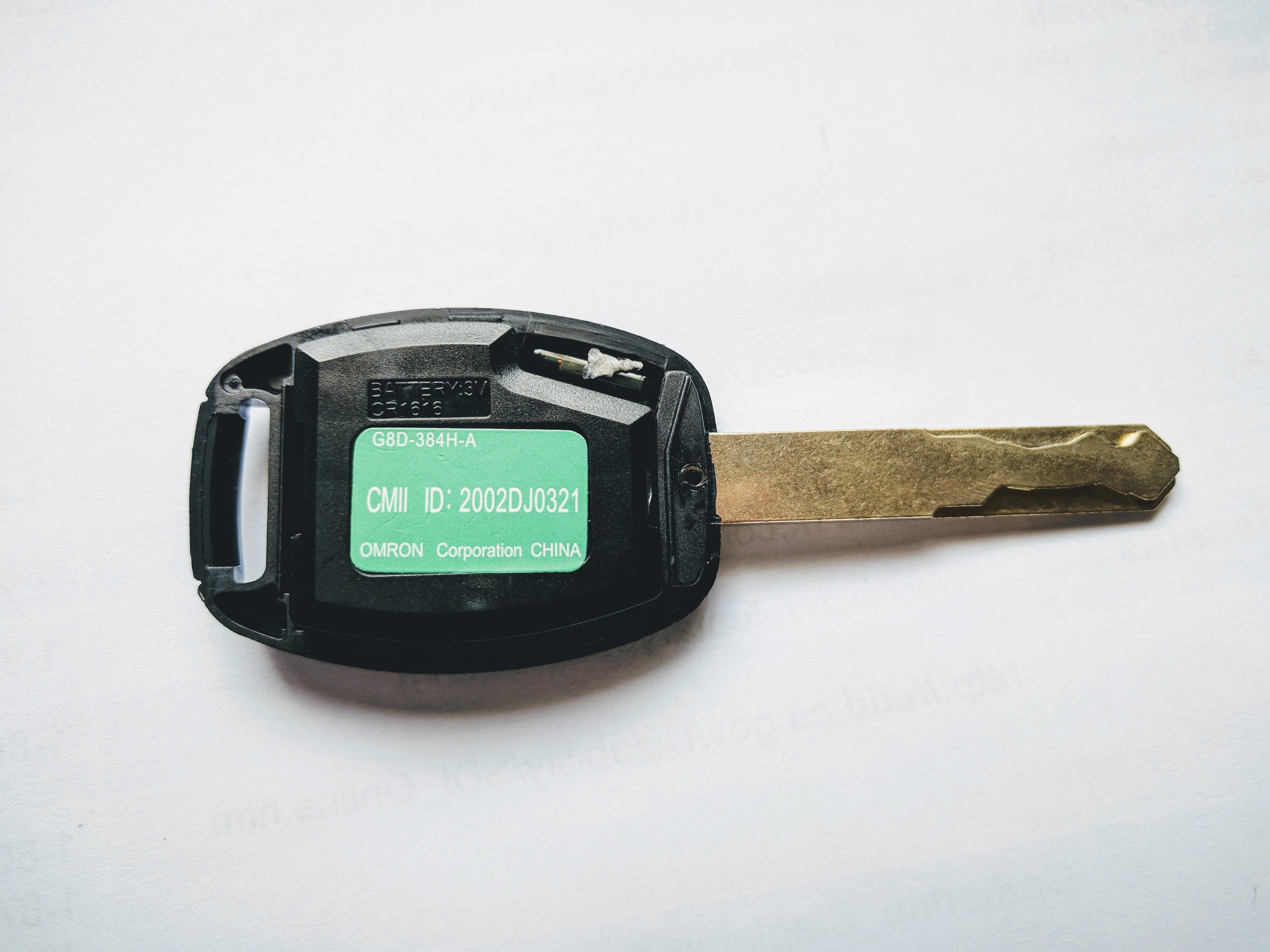

I opened the keys that came from eBay and the keyless remote said " G8D-384H-A" but my original key says OUCG8D-380H-A. I feared that it would not work and programming would not be possible. I found instructions on programming the remote the same night and paired the remote keyless entry fine.
From what I gather, OUCG8D / G8D is the frequency, and 380/384 numbers identity how many buttons are on the remote. The remote I purchased has Lock + Unlock + Panic aka 2+1 button remote BUT it does have a pushable button for the Trunk release but is not functional as the remote casing does not have the exterior physical button.

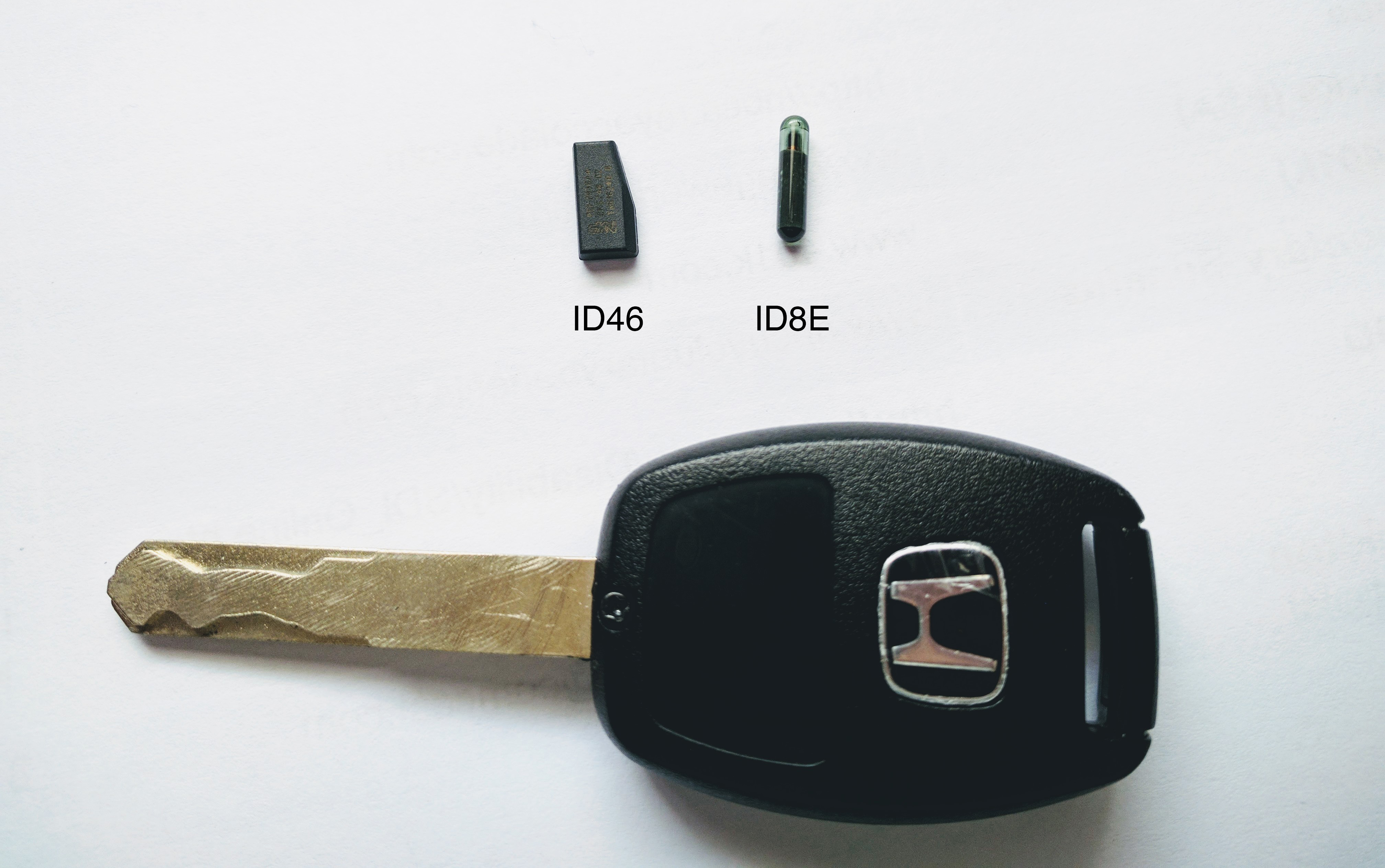

I found a second locksmith who has a 5* rating on yelp. He put my original key in his machine and it showed that the RFID tag is chip 8E. Cool. He then put in the eBay keys and immediately saw that the chip was ID46 and said they would not be able to pair the keys.
He had plenty of the ID46 chips but no 8E chips. I contacted the eBay seller and sent them a picture of the keys I received and he said they had sent me the wrong keys. They are sending me just the 8E replacement chips today which look different.
the ID46 chip looks like very tiny brick and the 8E looks like a medicine pill made of glass.

Comparison. ID46 vs ID8E.
I am going to the locksmith to have the chips programmed to the car later today.
