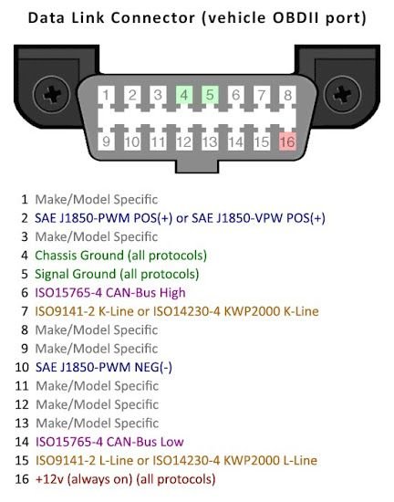

You can not just change the ECU. It needs to be programmed to the car security system, which means the VIN number must be programmed into the ECU. The following image is a pinout of the ODB-II connector, check for power and ground.
