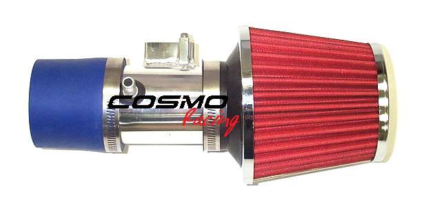

Hi fourm i just saw the diy on cold air intake/sri and was amazed i can make one for under $50, i saw how he cut the stock air box. does anyone make a 3" maf sensor adapter. i do not want to cut the stock air box.
example in this picture would be that middle piece

First off I believe the inside diameter of the Fit's MAF tube where the sensor mountes is 2" not 3". There has been some discussion about buying a MAF tube like the one you posted a pic of, but I haven't heard of anyone finding one that was small enough. Spectre makes one that is 2.5" I believe and the guys that tried it got check engine lights. It's best just to cut the tube out of the filter box cover just like in the DIY. If you're nervous about cutting up your stock box you can just order a replacement lid from Bernardi Parts (around $20 with shipping) and leave your stock airbox assembly intact just in case. That's what I did and it worked out great. The DIY intake sounds awesome and, contrary to the general consensus, I think it really did add a little bit of power to the engine.

Also, I wanted to add that the DIY mentions using a saw or kitchen knife to do the cutting. I used a dremel tool with a "roto-zip" bit (I hope I'm calling it the right thing. It's the bit that you would use to cut holes in drywall like for a wall outlet). It made cutting the tube out and shaving it down a piece of cake.
