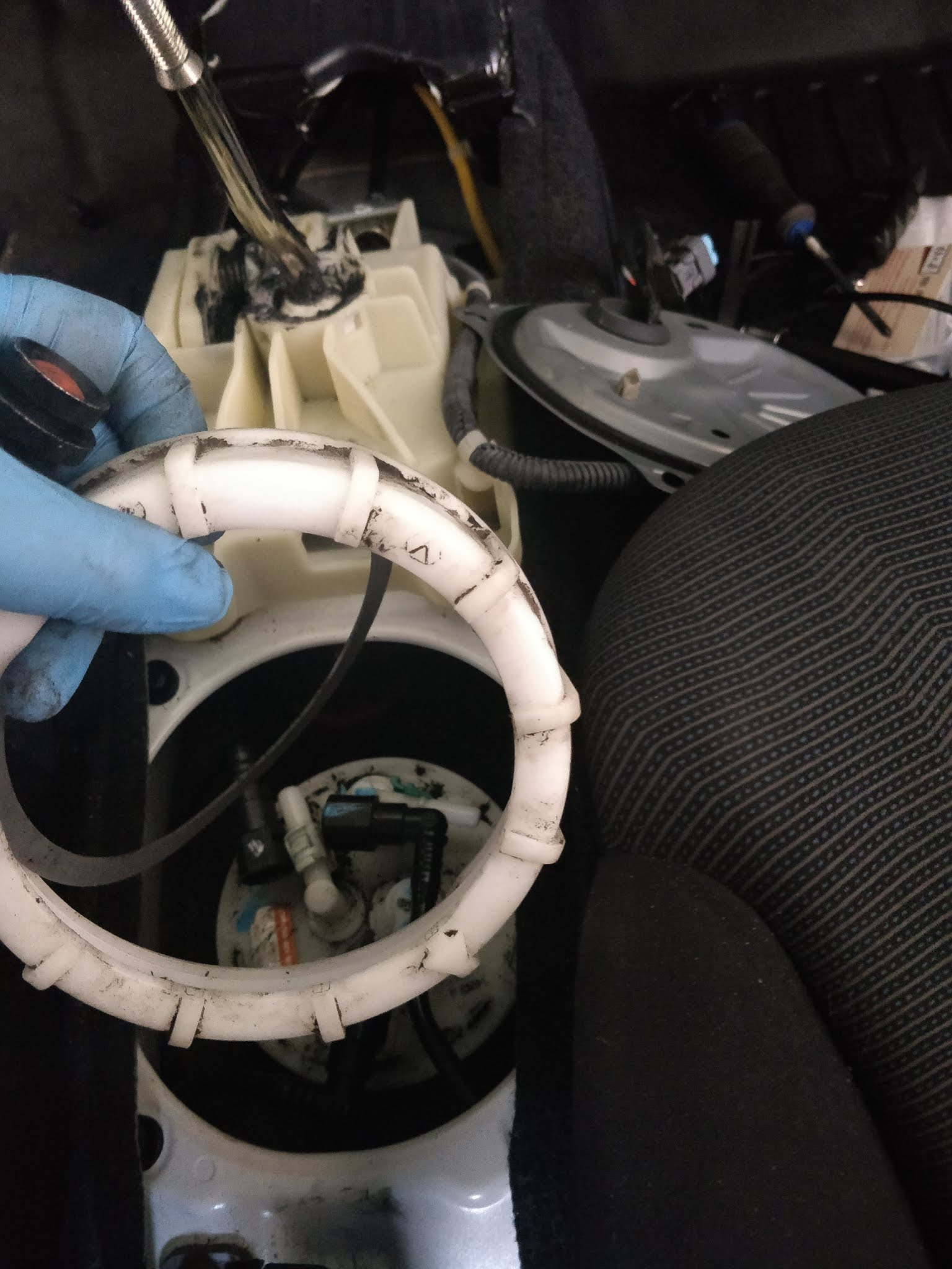

Fuel assembly stuck? Isn't this thing supposed to just come out after you remove the
Isn't this thing supposed to just come out after you remove the ring? The ring is really easy to remove with a regular gas tank tool. it allows you to just put a ratchet on it.

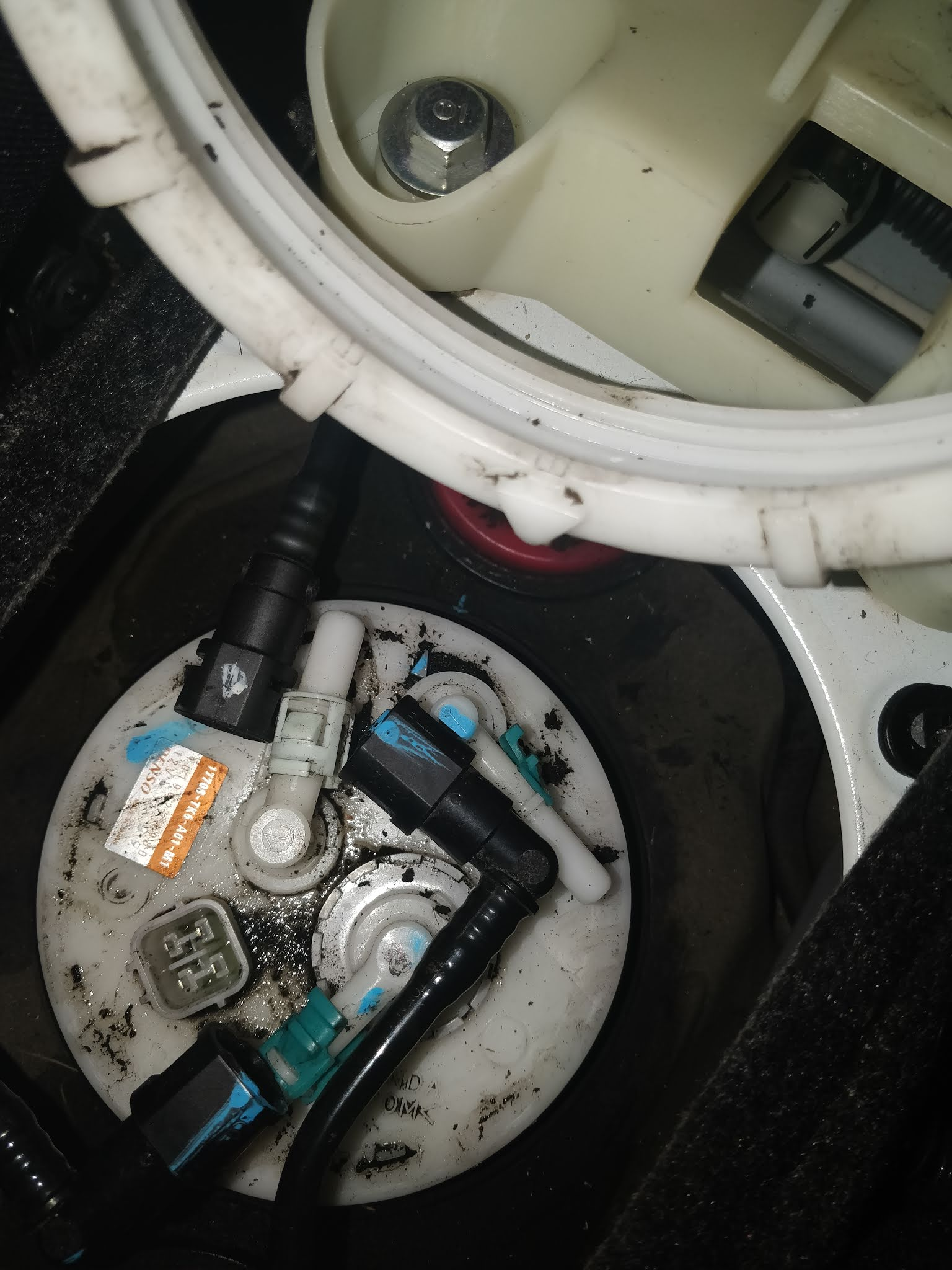

ok so here are the pics! help! i want to get this thing off while i still have light outside. PLEASE HELP ANYBODY
got it off!!! had to pray it out little bit little and go in a cycle using a pry screw driver!
