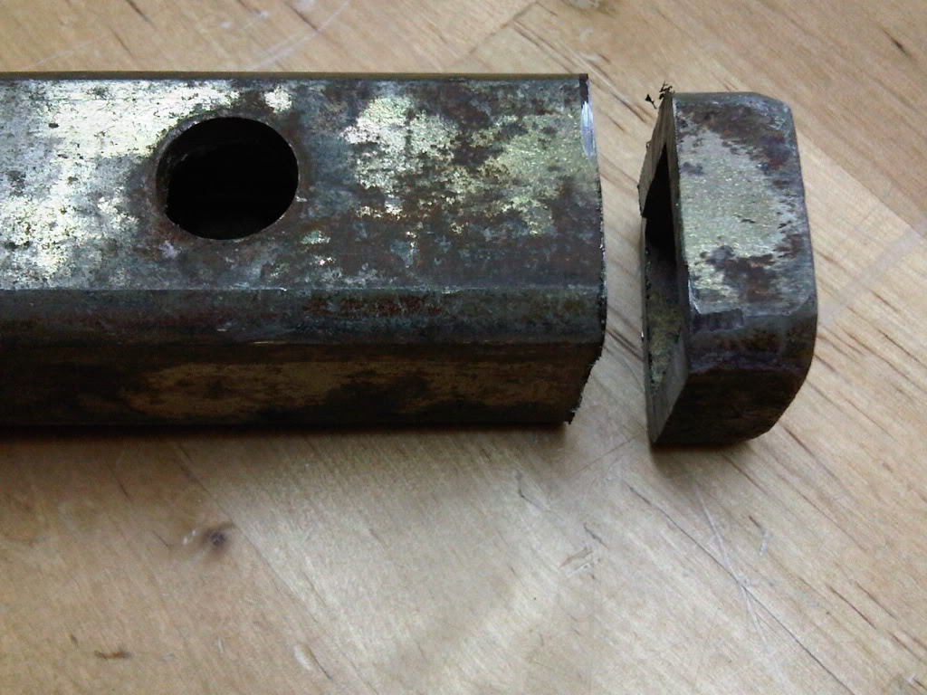

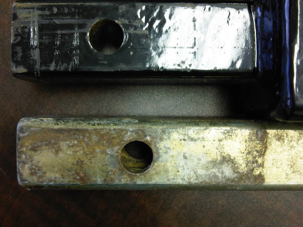

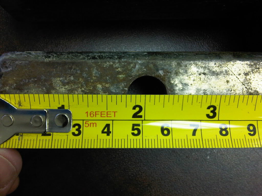

As you can see, the shaft of my Yakima Bike Rack is longer than both of the other 1/4" shafts that I had laying around. (Please note that it still fit in my Draw Tight hitches installed on previous cars.)
Both the Yakima (in gold) and other 1/4" shaft that actually fits (in black):
Yakima:
Other 1/4" shaft:
Buddy of mine cutting the Yakima with an angle grinder:

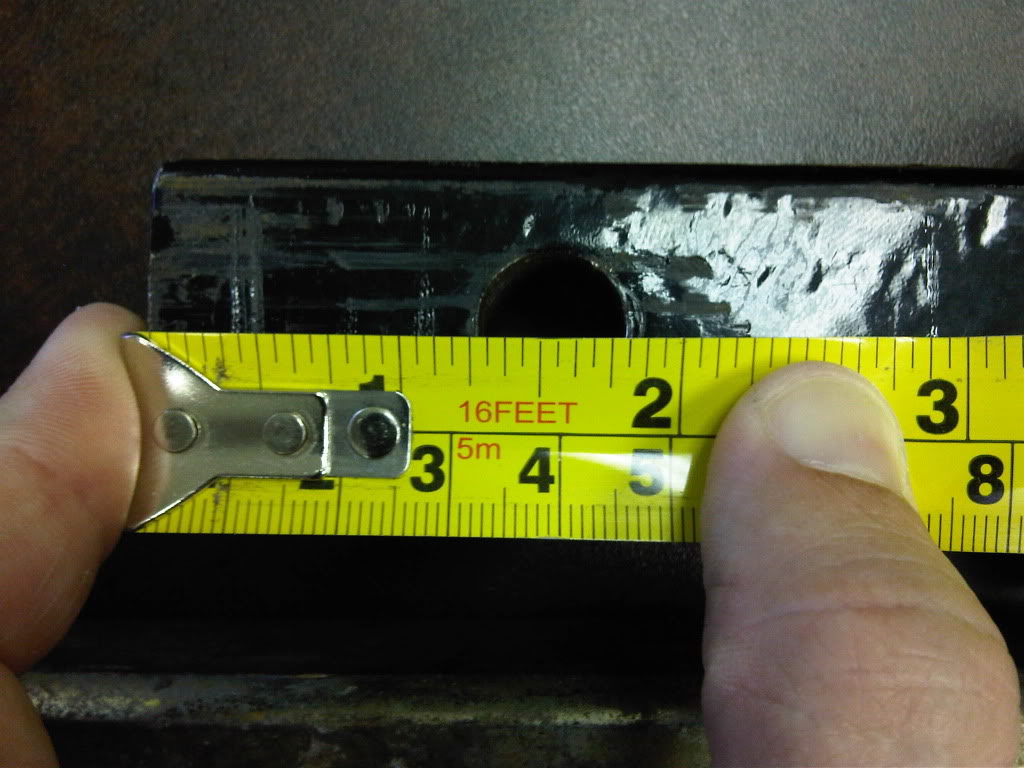

End result (it fits fine now).:
I will take a few pics with a bike or two on as well when I get a chance.
Thank you all for the advise. This thread actually kinda fun.

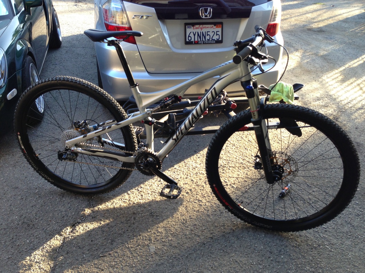

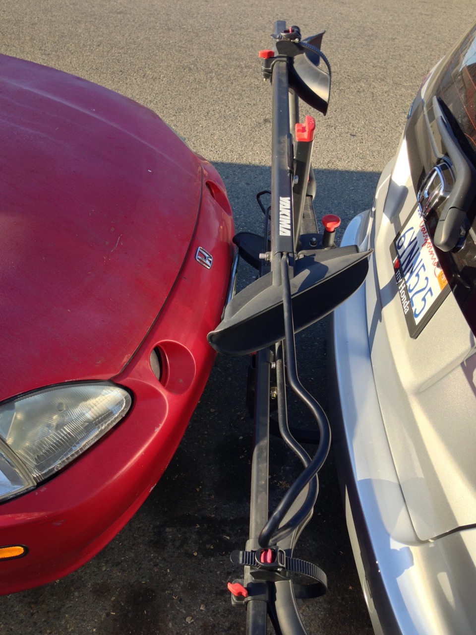

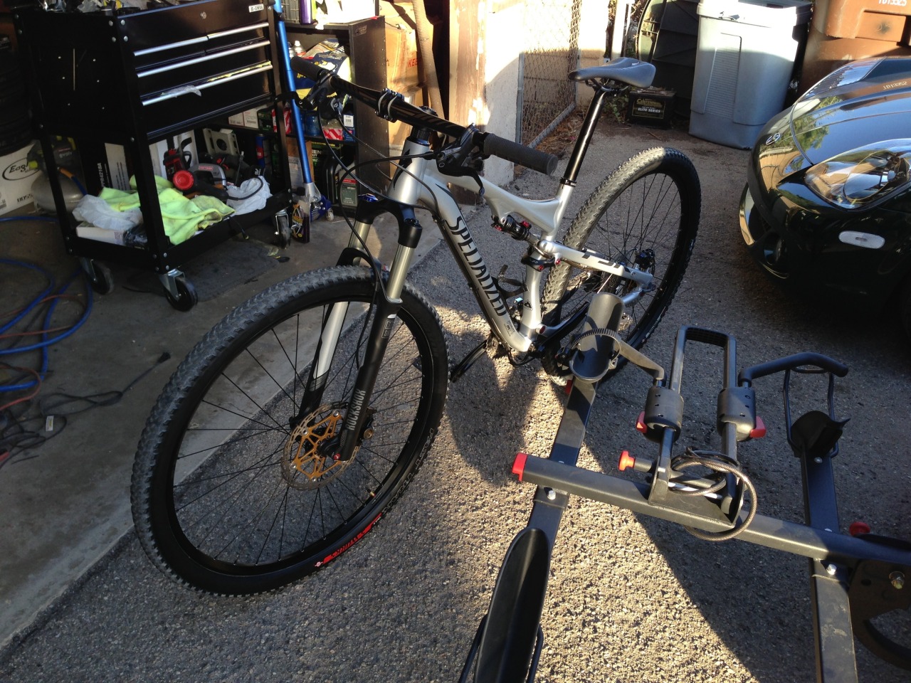

Old post but i had the same damn problem trying to use a Yakima "Stick-up" bike rack on my hitch. I ended up dremmeling a small notch on my yakima snout just enough to pass that stopper.
This is the rack i have
