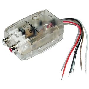

ok the 1st thing to is lay out your wiring. i used 4ga (ebay) amp kit, and the most important part is a LOC80 this is what I spiced into my rear speakers so the signal going to the amp would be the correct amplitude. LOC80 from Electronic Express on Amazon.
Is your a A/T or M/T ?Check ICE Where can you pull a power wire for your Amp. through the Firewall??
Lay out the power and remote wire down the drivers side and I used a accessory curciut from the fuse pannel (and fuse that at 3 amps) to a mini toggle switch under the heater controlls. This way I can cut off the amp and just run the OEM system.
After everything is wired up the LOC80 will need to be adjusted L&R channels, the amp will need to be adjusted to for what you want it to do Low frequienceis 2 channel prob. 4ohms. Then the head unit I set mine on "smooth" you get the hardest hits on that, the bass +1or+2, treb.+3 spr @ high fade +1 rear. and Use what ya got check the bottom of the spkrs for the ohm rating. This will let you know how to set up the amp. The GD3's has a 4ohm speakers I figure the GE8's use the same thing but research it to make sure. I used a single 12" Punch w/ a Rockford Fosgate 200w bridged amp made the box myself and bought a 12" grill off Ebay for 9.00 to protect the sub!! I have less than 180.00 in my system and it's Great! So if you already have the amp and subs it should be 40-60 bucks or< to get your Fit Thump'n dude . GLWA and if ya want pix let me know and I can post'em up. There are a few on my site you can check out.
