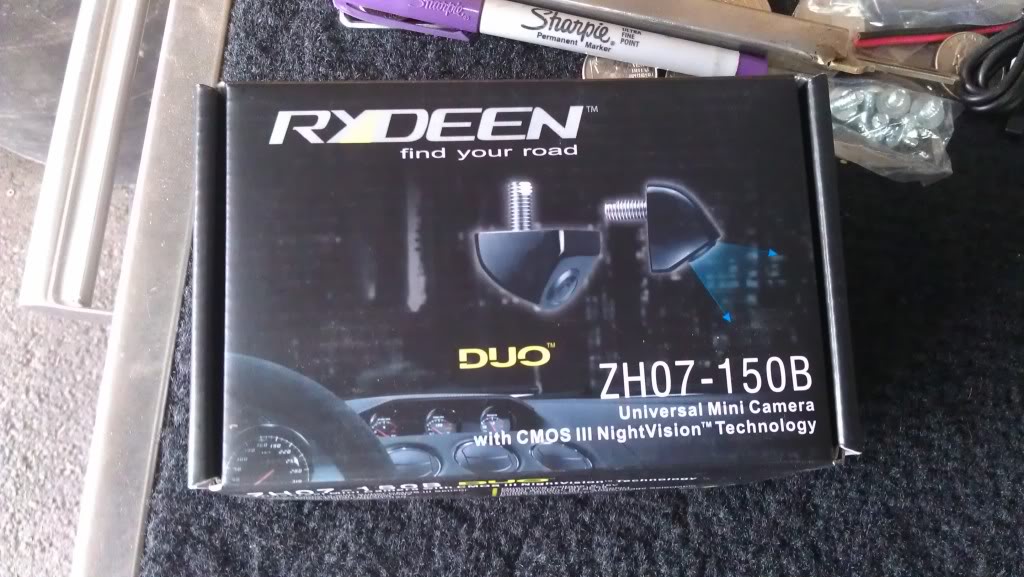

You will love your radio. I personally don't think there is a better double din on the market right now. That's just my opinion. Anyway, this is just a thought...
I plan on getting this camera and installing it where the squirter is for the back window. Here in AZ, it rarely rains so I wouldn't miss it at all. I just need to make sure the view won't be obstructed too much by the spoiler. I really like the Kenwood camera but my buddy said their is only way for the mounting option, so I am opting for this one.
The squirt nozzle would be more useful in the dry than the rain, as you want to get the window wet to really wipe things off the glass. And you'll have to cap it off and/or disable the pump for the rear squirt nozzle.
but the camera probably won't be obstructed at all, since you'll be looking more down than out.
A few of the places I thought about putting it were right on the license plate along the top. just above the top of the license plate, but this interferes with the hatch handle. On the underside of the spoiler, just out from the squirt nozzle. And finally, in the third brake light by making room in the middle of it (assuming it can even fit inside).
But the thought of figuring out where to mount it, then mounting it and routing the wire along with routing the reverse wire signal and splicing it into the car's signal wire after searching for it is triggering my "it feels too daunting" laziness mode.
