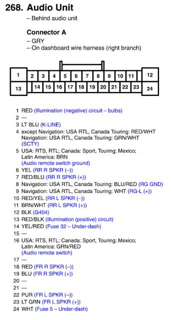

Hey, I know you already installed the Unika, did you ever try this? I'm thinking I may take the plunge. I'm already going to be installing the audio controls into my 2010 Sport. I bought this:
36770-TK6-A41 (A41 instead of A31 because I have A/T)
The BT buttons are 35890-SVA-A01 and apparently the info switch (which we have on the instrument cluster) is 35875-SMG-003. They look to me like they just plug into existing wiring on the full 36770-TK6-A41 switch assembly. The DIY article doesn't show this since the author just snatched the music control buttons and wired them into his existing harnesses.
I'm ordering the parts now so I'll install everything at once. Your wiring diagram showed exactly which wires carry the navi signals, so I'm pretty sure I can hook those up either to some Connects2 wiring or to a Maestro and leverage those controls on the Asteroid Smart I'm buying.

(wires 8/9)

Coincidentally, yes. I just got my car back yesterday after getting the Asteroid Smart installed. I haven't spent a lot of time with it as I've been busy doing some weekend work, but this evening I planned to take the car out and do a little testing.
At first blush, the bluetooth controls don't seem to be doing anything, but I don't have a phone paired to the head unit yet and there may just not be any functionality in my head unit for the buttons without a phone connected - I haven't read the manual so I don't know if the BT button is normally supposed to invoke voice commands or anything like that. We did not connect wire 16 (cablereel-side) to the radio because apparently the Unika didn't have any more connections for it, so I don't know if that wire is needed, or if we just don't have it connected properly. It's also possible that they didn't program the Unika correctly.
I have to imagine that the buttons are working though because if they weren't, when the tech programmed the Unika, he should have noticed that the buttons weren't triggering the learn response in the Unika.
