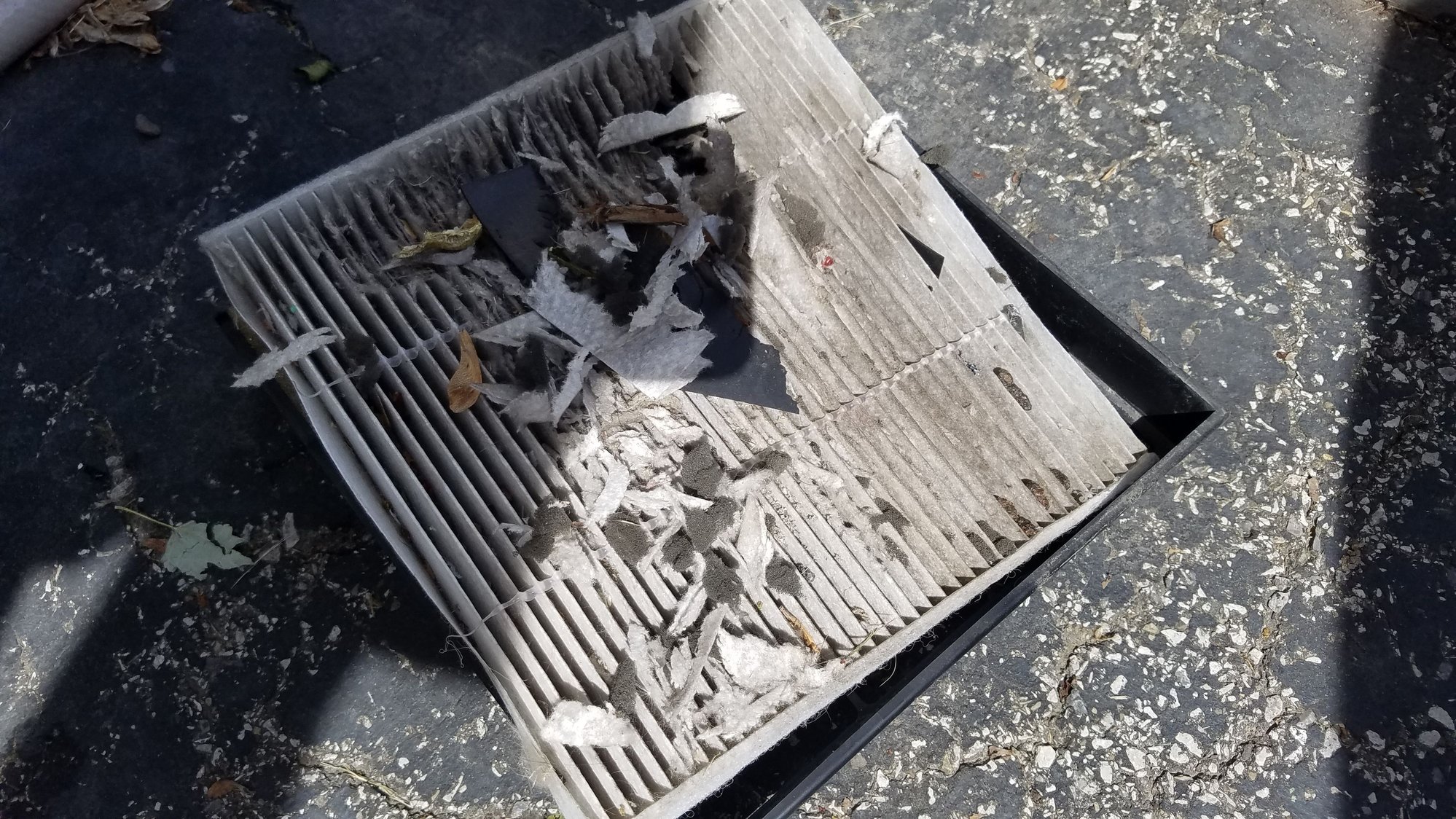

new filter time

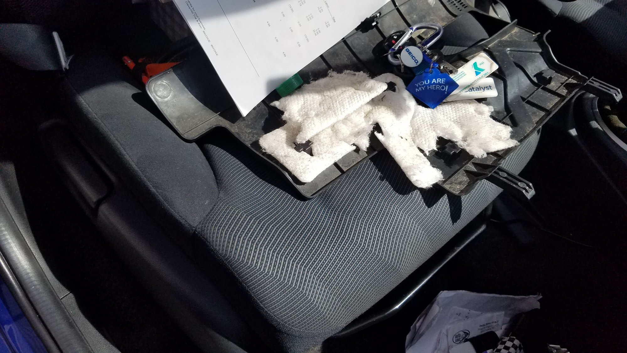

ripped apart lining behind the lower dash cover!!

Looks like you'll be replacing that plastic/foam pollen filter piece from your first image. Oh and the cabin air filter :{
I don't think anything there is missing though. In regards to that kick panel with the ripped up fabric there, I believe that material is for isolation purposes to prevent dash rattle. It certainly doesn't filter anything that I'm aware of. Could be supplemented with whatever material you see fit. say, carpet padding from a local home depot.
