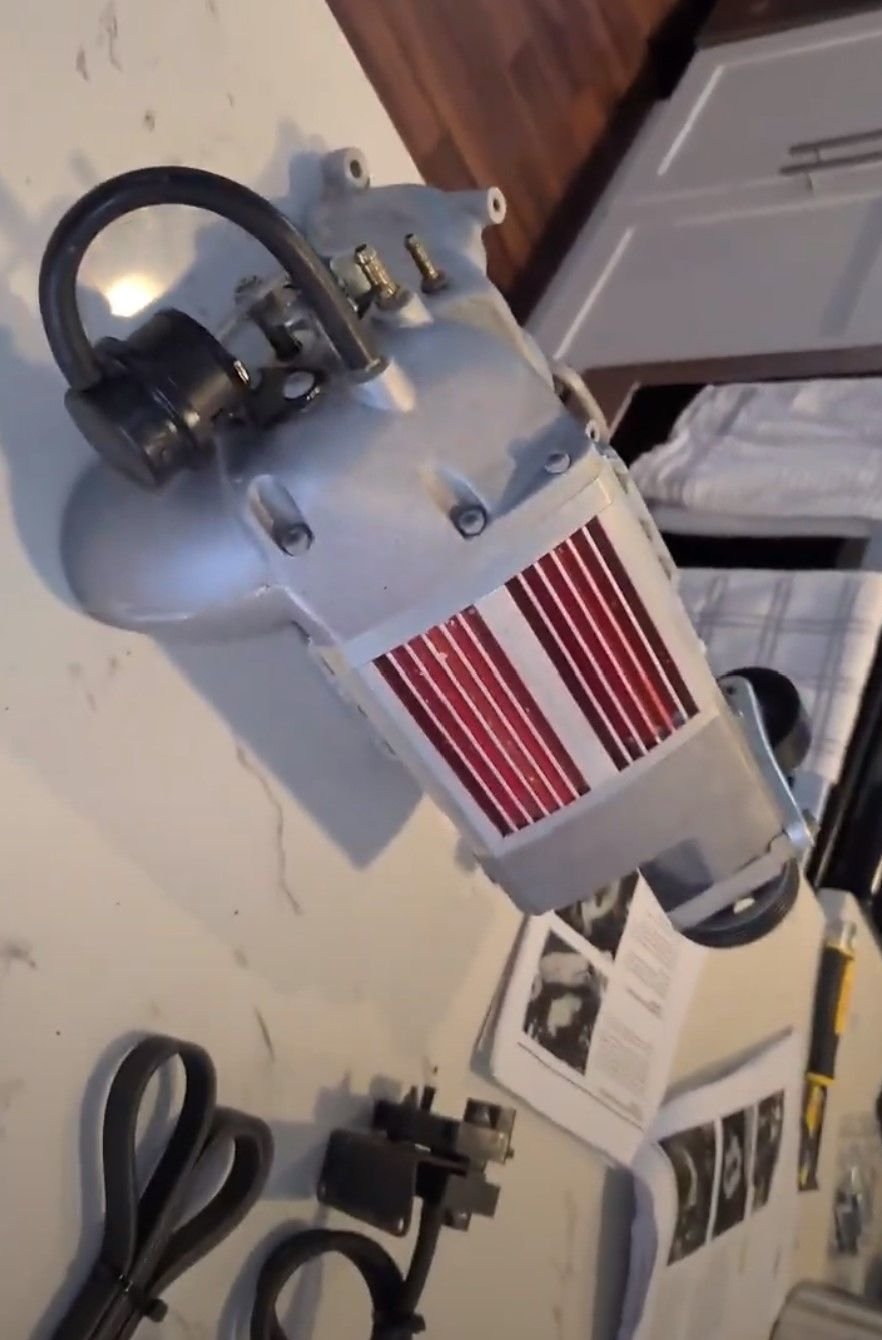

Update on my progress, I finally had enough free time and vacation to install my supercharger and associated parts. I have now a new issue that I haven't figured out yet (P0335 CKP no signal) but I'll save the inquiry at the end.
My progress:
We installed the radiator, fuel pump, full exhaust, and the supercharger exactly as specified in the manual. I didn't really take progress pics (apologies) but I do have some video of our initial fire up and tune experiences. I did keep the piggyback SM8TL but I feel it is the source of my latent issues I'm having with my crank sensor issue.
Video of it up and running:
https://photos.app.goo.gl/p2qLQKu9oTpkpQy46
