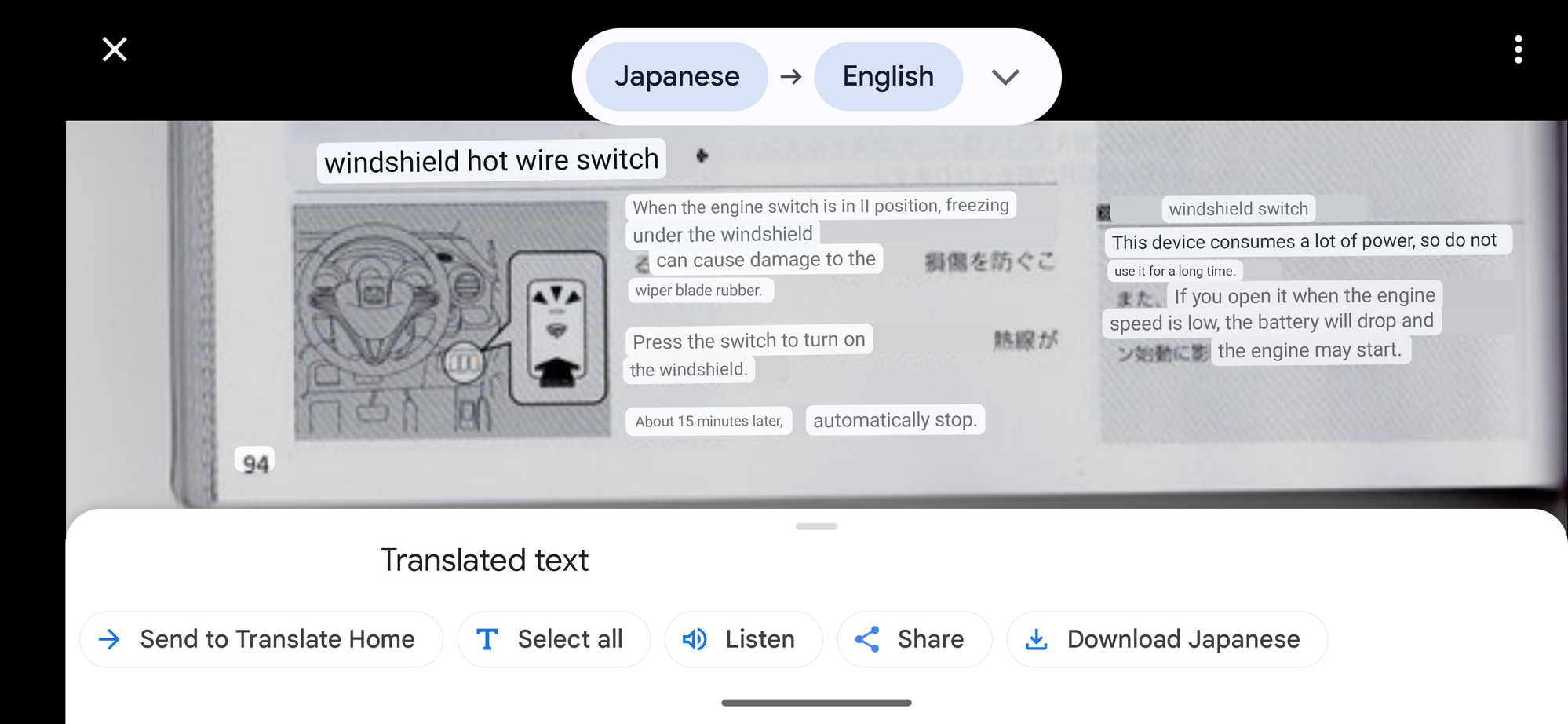

Optional wiper defroster for colder climates.

It's not too weird of an option, really. The Fiesta of similar year could be had with a windshield defroster. It's usually not an option that makes it to the states.
