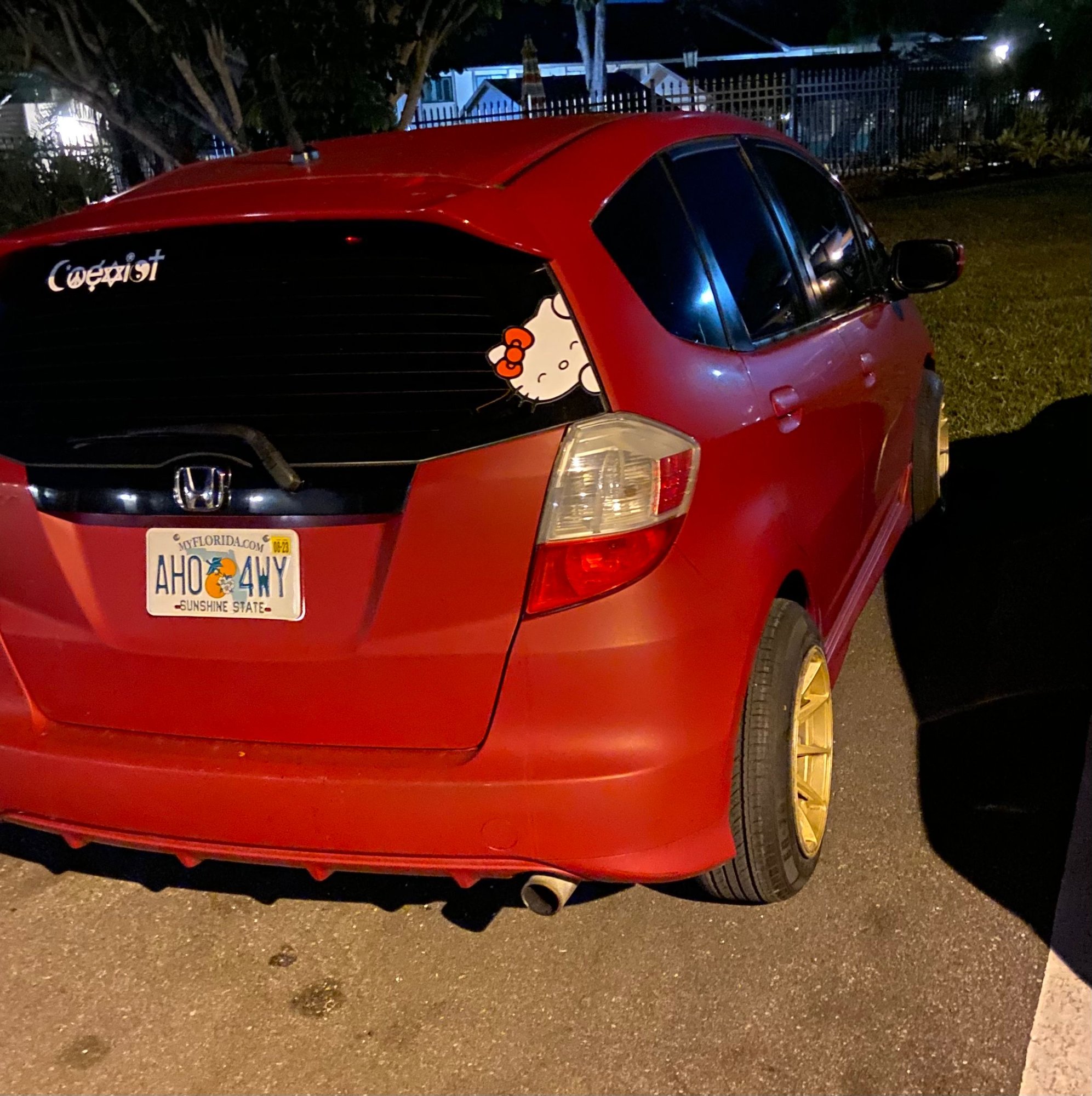

Im new to fits my mom gave it to me and ran it to hell so I'm fixing it up. I want new rims and stuff but I'm so confused with this offset crap lol. Im at stock height i don't really wanna lower or mess with the fenders or anything. I want size 16” but i want as thick of a tire as i can get without rubbing and i want them to be nice and flush with the car and want as much space filled in as i can. Someone just give me sizes please of wheels and tires thanks (pictures too if you can)
My dad put these xxr 527 15” and i think they are +20 and there is pretty much no rubbing only tiny tiny bit in the back if there is people in the back and i take a sharp turn, but not when only 2 people are in the front.

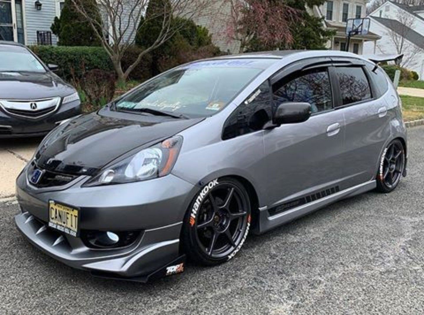

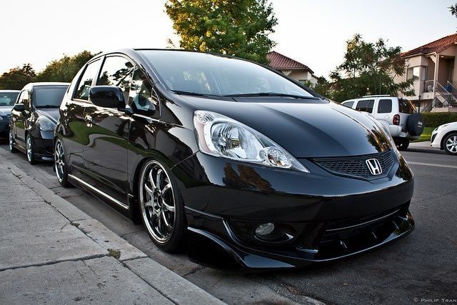

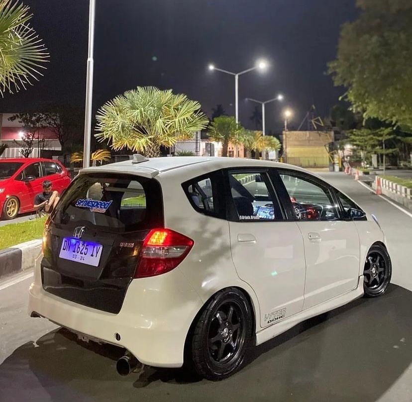

I feel you Im just excited haha. Ive been doing alot of research i guess i just cant decide but these are some of the ones i like. I am going to have it painted soon so Im still deciding on that also.

Cute Fit. Liking the Hello Kitty sticker
Looks like the paint needs a bit of TLC. Mag aluminum wheel polish made by Mothers should bring the shine back into the red without having to repaint. It will take a lot of elbow grease or you can use a DA polisher.
Liking the gold wheels.. however they appear to be too wide and incorrect offset for the car. Maybe the wheels are a 15x8?
For the look you are wanting you will want to lower the car a bit and run some 16x7 or 17x7.. You can run anything 15-17 inch rim in a 7 inch wide wheel. Any more you will run high risk for rubbing. Offset is also important you will want an offset between +35 ~ +45. Anything lower than +35 you will run higher risk of rubbing.
