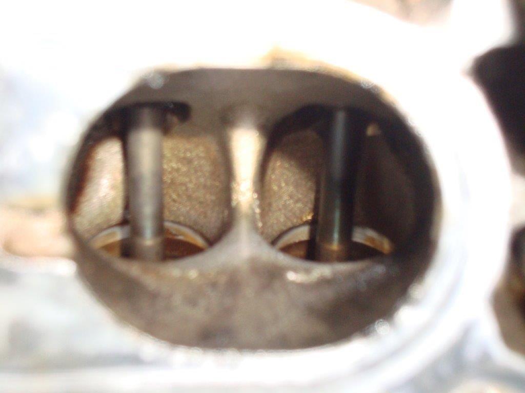

Homing in on the CEL Problem?
As it turns out, after removing the upper & lower intake manifolds, and accessing the intake ports- they are clean! I don't have GDI, but port injection! Will not do the walnut shell blast and just scrub with with sundry cleaning solutions and brushes, reassemble and be done with it. I am returning many of the unused tools/materials until it comes time to do the wife's HR-V (which I think is GDI). If am am still between jobs I may pursue offering the service to others.

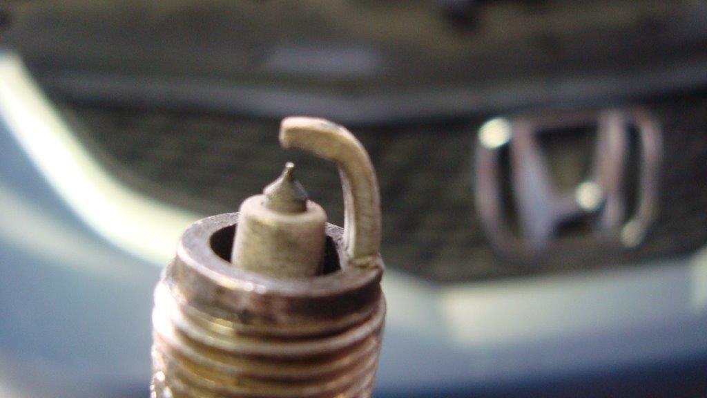

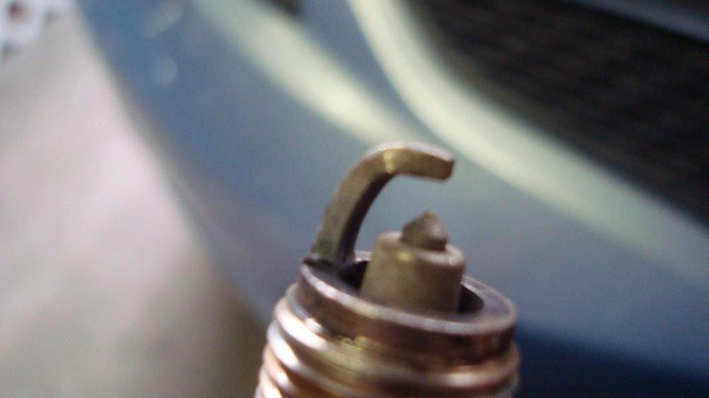

Did quite a bit of disassembly (throttle body, fuel rail, air boxes, battery- having the upper intake manifold out of the way made for quick work of replacing the injectors) What I did find, aside from minimal junk inside the ports, was # 2 spark plug (Denso Irridium, bought on Amazon) has a faulty electrode! Don't think it was fried off, as no indication of excessive or big heat/spark, so I probably installed a flawed plug, as was. Can't say for sure, but am hoping it solves my CEL-at-freeway-speed issue. It coincides with the # 2 cylinder misfire code. Going with NGK Irridium izfr6k (pricey). I still believe the OEM fuel pump module is helping, as the codes are becoming minimized/specific, after changing out the knockoff module, also replacing the non-OEM coils with factory parts may have aided in cutting down on the code. Again, not sure but as I plan on keeping the car, forever, basically, it offers some peace of mind, if nothing else (have gone cheap-to-midrange on many parts in the past and I am in "the 3rd act", if you will, ergo, I am wary of going too cheap, these days.
Pre-cleaning- Looks like most of the "after" cleaning photos!

# 2 plug- note no tip on electrode (see other plug pic, attached here, for comparison as to what it should look like
Proper electrode

Looks like you'd be right on the money there. Can't see it too well but by the bad plug posted, if the blackness is ashy, means unburnt fuel normally, hence the code. I think you'll like NGKs, they're awesome. Good luck!
