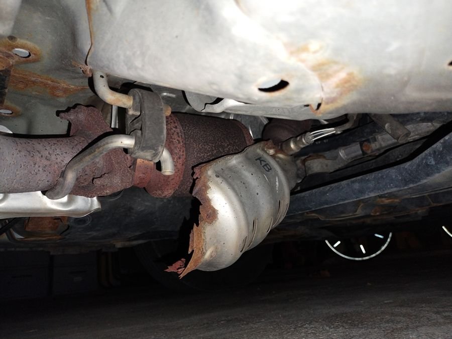

I got a good look at that when I was replacing the heat shield (bolts had rusted out). One time I replaced an oxygen sensor and rented (free + return deposit at AutoZone, Advance Auto Parts, etc.) a special socket with a cutout so the part could be removed without cutting the wires. Of course, you could just cut the wires and use a regular socket when you remove it without damaging anything and smoothly install the new, perfectly functioning part on your first try. Could be the converter too/instead though.
You can't get under the car to that location without a jack and 4 jack stands (back end raised first). The front jack point is buried deep in the frame, but you can access it without a low-profile floor jack if you take the handle through the front wheel well area.
Assuming rubber aging is the only problem, you can sometimes fix squeaking in cold weather by spraying front suspension bushings with a lanolin-based lubricant designed to prevent rust (Fluid Film, PB Blaster Surface Shield). It worked for me. I also sprayed silicone-based lubricant directly onto the shaft of the front shocks after lifting up the cover. You don't need to raise the vehicle to get to most of it if you're flexible and don't mind being on your back; just turn the front wheels all the way both ways and get a piece of cardboard for the drips. TPMS sensor? I don't know. Good luck with that.
