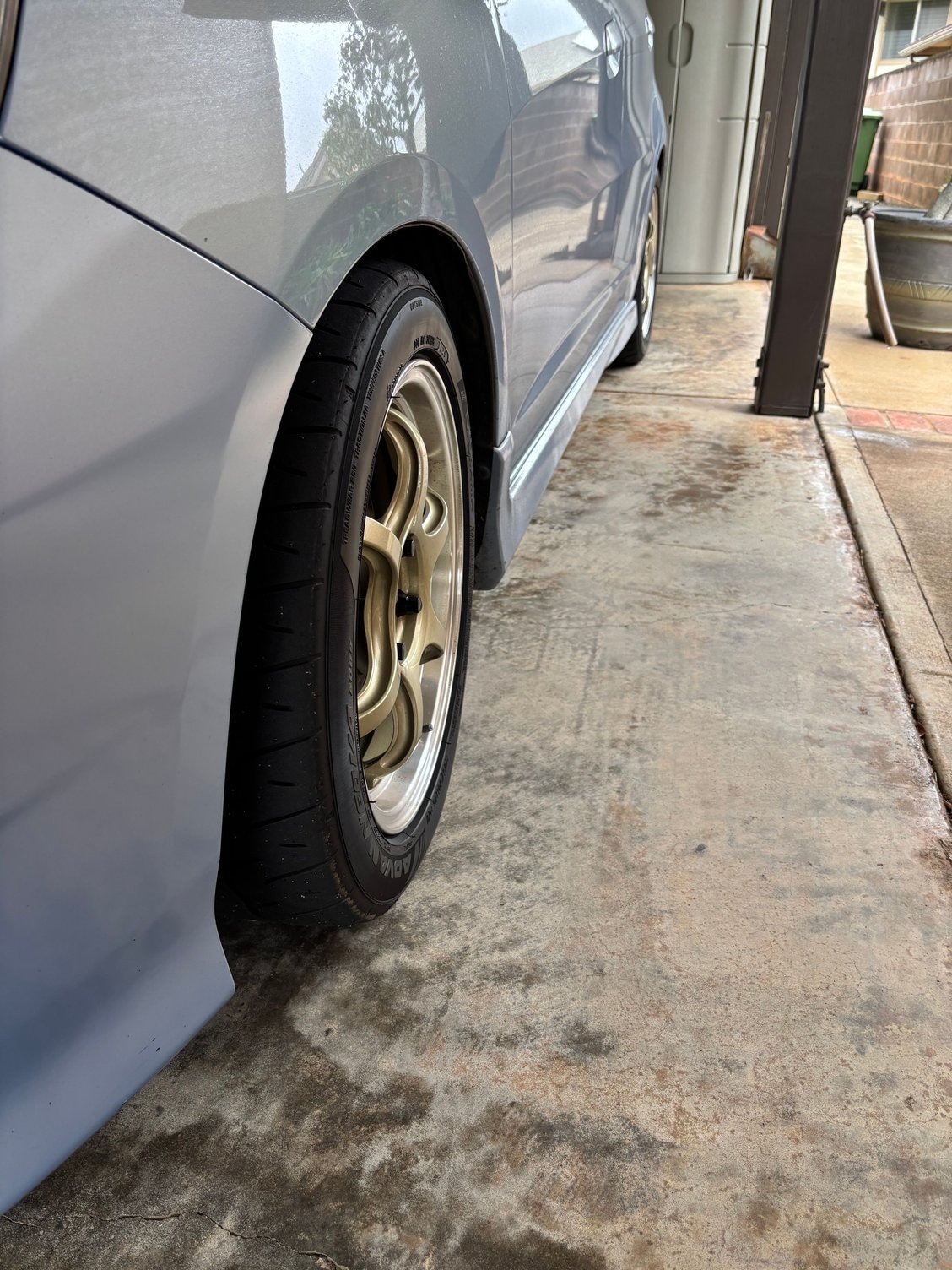

Is any lowering possible with 205/50R16 on a 2009 Sport and +42 offset?
Old Mar 11, 2026 | 06:40 PM
Bugger's Avatar
Joined: Nov 2015
Posts: 2
From: Mililani, Hawaii
2010 Sport
16x7 48mm offset Advan RGD2
205/50 R16 Advan Neova tires
Bilstien Coil overs set at 2 finger gap
SPC camber bolts maxed out negative 1.5 degrees negative
Fronts rub under hard cornering and harsh bumps while turning. The sidewall are very square on this tire.
