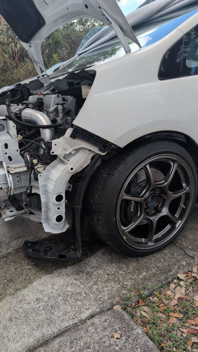

Got the car setup enough that I could figure out how to get my Tl Type-S Brembo brakes to work on the fit. For those that have not been following my "its the little things" build page. I am actually running 8th generation civic knuckles and coil overs on my fit. I used that combo to give me better suspension options and larger axles options for my kswap. I had to switch to insight lower control arms from my cr-z lowers I was running to give me clearance I needed. I added a video at the bottom where I talk about it more.
I also post alot of quick videos on facebook group Modified Honda fit
