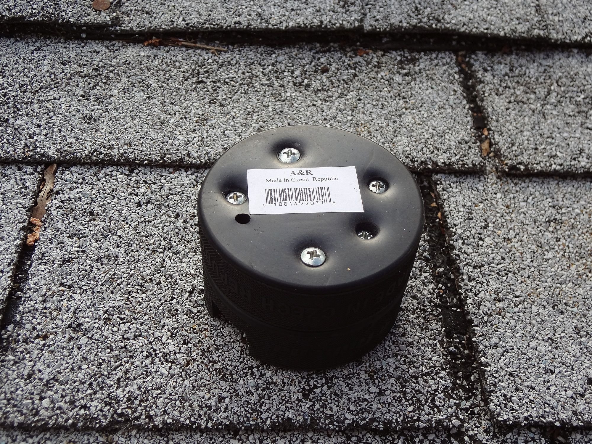

I don't like putting the metal jacking plate against that metal piece under the front doors. Instead, I use hockey pucks. I cut a piece of wood to fit onto the jack plate, I cut a hole in the center of the wood. Using a table saw, I cut a wide groove into a hockey puck. I screwed that on top of another puck. When I jack up the car, the groove in the rubber puck is contacting that piece of metal.
For the rear, I use an uncut hockey puck.

The jack tabs are thick steel that extends through the bodywork to the frame rail. The long seam between the front and rear tabs, sometimes called the drip rail, is a few spot-welded layers of thin sheet steel which is designed purely as a joint between body panels. The jack tabs are designed to carry the weight of the car. The drip rail is designed to shed water while protecting the inner layers of the body. Use the jack tabs to lift the car. Lifting the car by the drip rail, the body panels on either side of the drip rail, or any other body panel, is likely to damage them and/or their rust-protective coatings.

@SilverEX15 I like that hockey puck with the groove.
@bobski He's not lifting by the "drip rail." The groove in the hockey puck relieves the drip rail and allows the jack to only contact the underbody. I can't imagine that the underbody between the "jack tabs" is not as strong as the jack tabs. Are you saying that it is not as strong?

That's exactly what I'm saying. The unibody has thicker internal elements that major components like the engine, suspension and bumpers attach to. The jack tabs extend into the body, attaching to those elements, as well as the thinner stuff along the way. The drip rail is composed of a sandwich of what are more or less cosmetic panels. Those panels do contribute to the car's structure, but they're not designed for lifting forces. The rail itself will crumple from forces the tabs just shrug off. The panels on either side of the rail can dent or even tear through, though a large rubber pad should help spread the load.

Look at the picture from Honda. That's exactly what I do with the hockey puck.

Do those lift arm ends look like hockey pucks to you? ^_^
It has some merit. A service lift is going to keep the body level while lifting, so the steel always-level arm ends are going to maintain good contact with the tabs. That isn't the case when using a jack on a jack tab ("support point"). Jacking one corner (or one end of the car with the jacking brackets) will put the body (and therefor the jack-contacting edge of the jack tab) at an angle, opening the possibility of the tab slipping on the jack. This is pretty common when lowering a car onto jack stands, and one source of "settling" when doing a wiggle-safety-check. The rubber puck should provide some traction and mechanical compliance against the angled tab.
