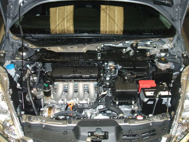

I started off removeing the cowl panal plastic

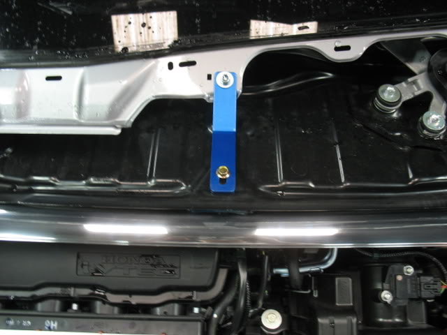

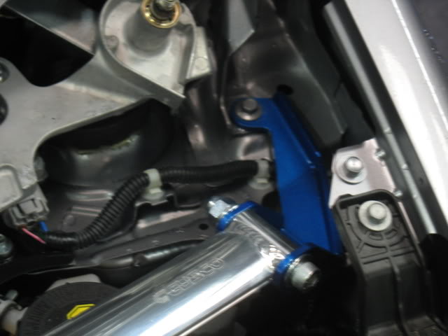

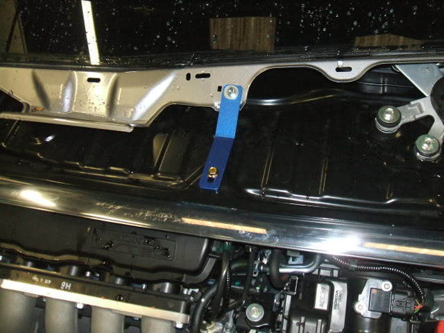

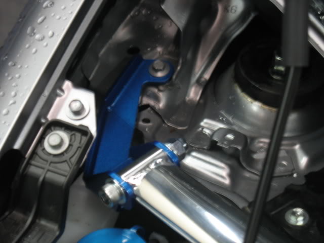

Then i set the bar up in there and found which bolts to remove to install it.

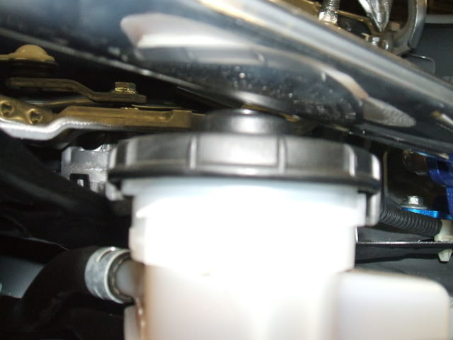

and then tighten then up and barly cleared the brake resivor i had about 1mm of space cleared

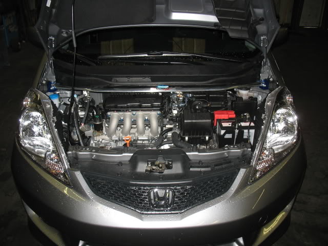

but then i popped the cowl back on and it was done

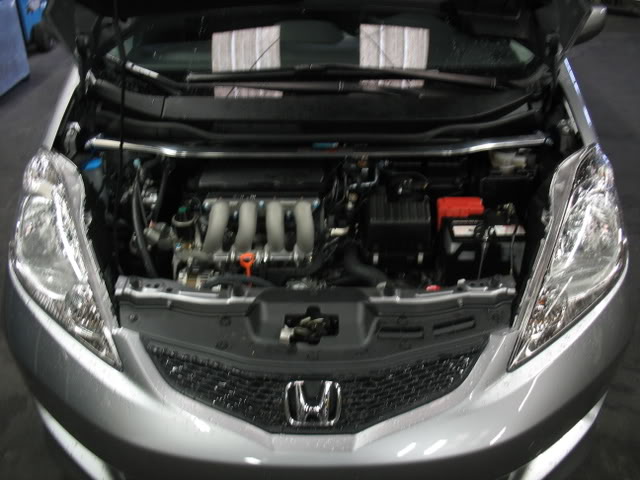

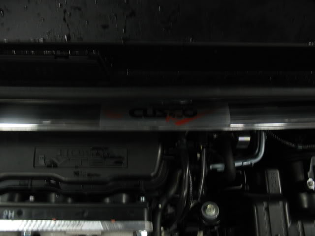

here are some bonus pics

man that is close on the brake res
thats going to suck when you have to add
fluid or change it. but then again how often
does that happen

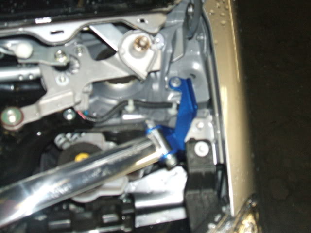

whats that blue bar in the middle of the engine bay? does it make the bar a 3 point?

well there is a offset bracket that i am still waiting on to fix the brake res problem. the front bar wasn't saposed to fit but it did. and it made a world of a difference, more responsive steering. i love it
I'm not sure why it is there but it had hardware and was in the instuctions

how long did it take to remove the cowl? is it a pain?
+1 rep
Old Oct 24, 2008 | 07:01 PM
TWGE08's Avatar
Posts: 242
From: SoCal
Another good job +rep. Can you give us more info on how to remove the cowl?

It just pops off with a little presure. but take off the ends first
Yes... 3 point ( kind of )

Looks great, but how are you supposed to refill the brake fluid?

one bolt per side and one in the center... and as for accessing the brake res on a USDM car they make a bracket that lowers the res down about 10mm for the USDM version other than that the bars are the same

As often as i change the brake fluid on my 2009 fit, i'll just pop off the bar when i finally do.
