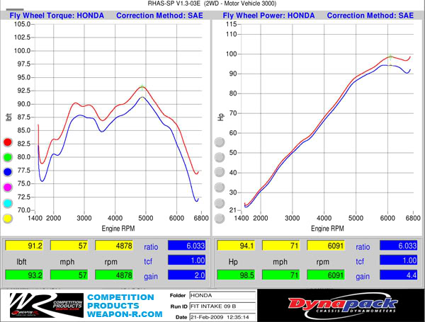

Here is the STOCK vs. The 2.5" MAF Sensor Section. The ECU totally Didnt like it..

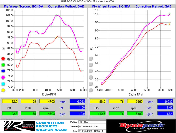

Here is the STOCK vs. WR Cold Air..

This seems like more realistic numbers....
soooo which 1 is the right one? 12 hp gain on NA just intake with out tune is huge!!...
but isnt dynapack read on hub? not the wheels?

The intake is not even out yet...
I dont even have a picture of it yet, and i work there..
Yes the 12hp gain is correct.. Alpha will have videos up tonight..
And yes dynapack hooks up to the hubs and not the wheels/tires..
Which means what? Means that its more accurate than dynojet or mustang..
If you think 12hp on a Fit is too huge of a gain..
The does the K&N banner that rotates on this forum and many hundreds of forums a CROCK of ISH also..?
2006-09 CORVETTE 27HP Gain / 2007-08 Shelby Mustang 53HP Gain.. Suddenly 12hp doesnt sound out of reach for a super effecient engine that has vtec..

But that is the thing. It is all a crock of ish.... It has been proven time and time again on the forum that intakes(for the fit) are putting out 3-5 tops and it is usually lower. Like I have said before and will say again how do you expect anyone to believe this when a supercharger is only claiming a very small amount more than what your claiming for just an intake.

Don't compare intakes for vettes and stangs. Its a completely different application. You have a 6.2L V8 gaining 28whp. I can see that. The Fit is a 1.5L 4cyl, to make 12whp is a miracle, the engine in a Fit compared to a V8 vette is more than 4x smaller..
Dynapacks are not more accurate by any means. And the Kraftwerks SC made the increase on a dynojet. If you take 10whp gain on a dynojet and put the same car on a Dynapack you'll get a silly number like 20hp increase.
Someone once said to me that every 4lbs you can take off of rotational mass is equivalent to 1whp. So, if we take the stock wheels of a Fit which is probably ~35lbs? then you can take 9whp off the total. Not sure if this is true, but I would guess that if you took the WR intake and put the same car on a dynojet you'd see about 4-5whp gain.
If I took my car and put it on a Dynapack, I'd see about 200hp at the flywheel. I made 170whp on a Dynojet. There's the difference.
I think the best thing to do to prove it to all the nay sayers here is to put it to the test on a dynojet, those are the numbers ppl are used to seeing on this forum... and if they are as good as they seem then good 4 you guys for breaking the max intake hp increase number for any honda out there!

I think as long as you have the baseline to compare using the same system and calibration you should get usable results.
