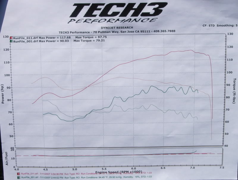

Our fits already have i-vtec. Honda didn't make our cars with power in mind.
Their main goal was fuel economy and comfort. I'm sure a few more whp could be extracted from bolt ons. But not this much.
I agree, but have higher hopes than a lot of you guys for the L15A7. It's high compression & head design should let it breath just as well as, say, a D16Z6 or D16Y8.
The HP bottlenecks will likely be the ECU for affordable tuning & the in-head exhaust mani unlike the aforementioned D-Series engines.
I've been a fan of D-Series engines for a decade & have seen & built some unbelievable power with cheap, simple mods & refuse to accept that Honda made an
untuneable little engine series lol.
My '91 Civic STD hatch for example. Bone stock the D15B1 made 59.5 whp, got it to 117.7 whp with an MPFI swap, stock D16A6 camshaft, I / H / 2.25" quiet
exhaust w/cat & ECU tuning on a 97 degree day...
Now I'm by NO means saying we could pick up +92% hp with the above mods.. D-Series engines were SOO detuned for MPG & reliability..
I'm saying that when the aftermarket & amateur tuners like myself find the bottlenecks in the L15A7 & remove them, there's no reason to
think our little engines can't pick up fat chunks of power & surprise or downright smoke some underestimating drivers. We'll never have
K-Series power N/A but we might see power like my D15B1 above in a few years.. that little car made a lot of people mad lol.
