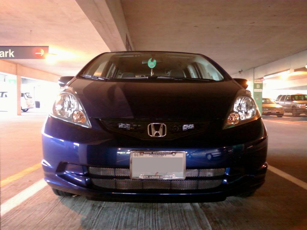

I installed that aluminum gutter guard (sold in a five pack at Lowe's) this weekend, on my 4 day old Fit. I like to know she's safe.
I did have help from my boyfriend, though (he operated the wire snips a lot fast than I can, and it looked nicer afterwards).
I have a base fit, so the cable ties are a bit more noticable than on the sport, since the paint color carries down to the lower grill area. You still can't see them unless you are looking right at it from a foot away, while squatting down.
I can't find the thread that had this specific idea in it, though. Was it this thread? It worked great, it took a while because I was having a bit of heat exhaustion and went a bit stupid, but still well under 2 hours.
I actually like the way it looks in real life. More than before, no lie! It looks a bit more finished, and sporty. My bunny car has teeth!
Sorry for the lousy picture, taken with a camera phone in a parking garage. My car is a bit dirty anyway (sprinklers! Argh!), I was going to get it washed... but with this picture quality, you can't really tell!
