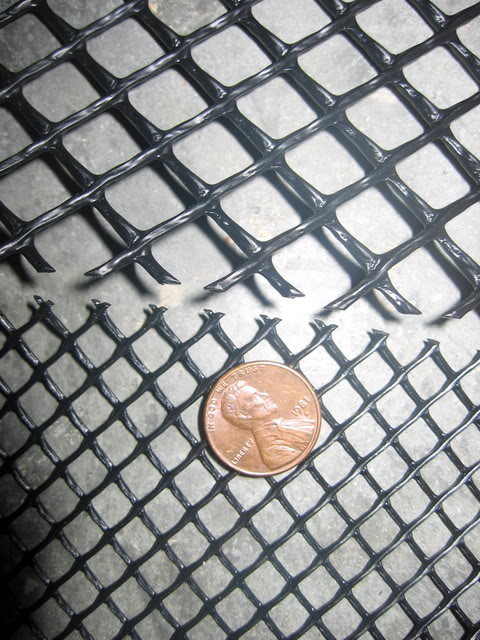

I started here:
McMaster-Carr
And ended up with this as the best option, in black plastic!
McMaster-Carr
I'll post my findings once it arrives. It was $10 shipped LOL!

I got the meshes in from McMaster yesterday. I actually bought the one linked above, and the next size up. The one linked is the best size, the other one is too large a grid to be useful.
I will take some pics of the meshes with a coin and ruler next to them so you get the idea. I'm not sure how durable this is going to be, it's just plastic, but seems quite strong... I may run a few projectile tests at it to see what happens Will post more soon.

OK, here are some pics of the meshes I purchased from McMaster-Carr. They are black, and made of plastic (injection molded).
Personally, I think the finer mesh is more appropriate for shielding...
Top mesh is 9314T35
and
Bottom mesh is 9314T33
