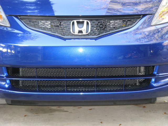

Post Another pic
Originally Posted by Alpha Zero
That actually looks pretty nice. More pics?
Here you go:

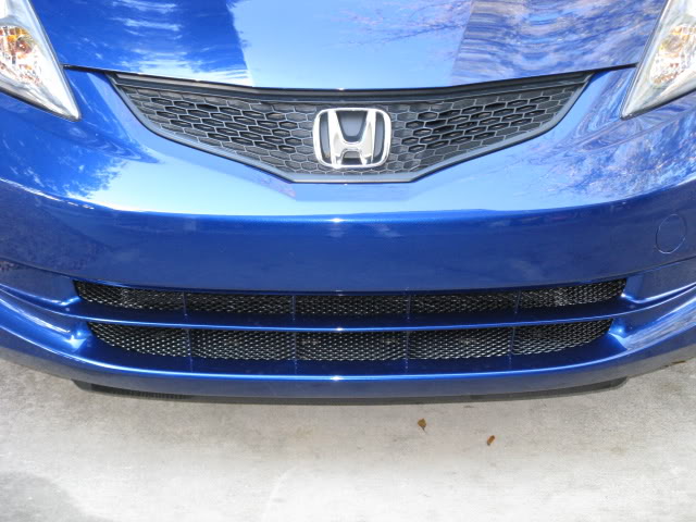

Here is my grille. I have a base model so the opening is different. The openings appear to be larger than the sport model! Oh well, it is fixed now.

See the zip ties? No?
How about now? You can't see them when standing in front of the car because of their position. You can't even see that that well when looking right at them.
This is the mesh that I bought... eBay Motors: UNIVERSAL BLACK ALUMINUM MESH GRILLE GRILL 12" X 48" (item 270345393847 end time Mar-17-09 21:11:22 PDT)
Installation was not bad at all as I did not have to remove the bumper.
1. Open hood.
2. Remove the clips holding the top cover on.
3. Use a piece of cardboard to make a template.
4. Insert cardboard down into the grill and press forward.
5. Trim areas needed and refit.
6. Trace cardboard template onto mesh by scratching the mesh with a screwdriver or some other sharp tool.
7. Cut mesh.
8. Slide down into bumper. Will only have to bend it slightly.
9. Push forward as far as you can.
10. Find the tabs that are on the back of the stock grill. (Rectangles in pic below.)
11. Cut holes in mesh around those tabs with wire snips and push over them.
12. Use zip ties to secure in locations on pic below. (Circles in pic below.)
Sorry about the 3rd grade photoshop. I'm lazy but you get the idea.
