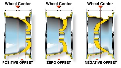

just a quick explanation too
a +50 offset would be more negative and a +30 would be more positive
i think you meant +50 is more positive, and +30 would be more negative. which means +50 sucks your wheel in more towards the center of the car, while +30 will make them stick out more towards the fenders (if we're talking about two wheels of the same width).

Good drawings except the wheel centerline is halfway between the inside of the rim flanges rather than outside as shown. Surprisingly, not all wheels have the same flange thicknesses on both sides.
