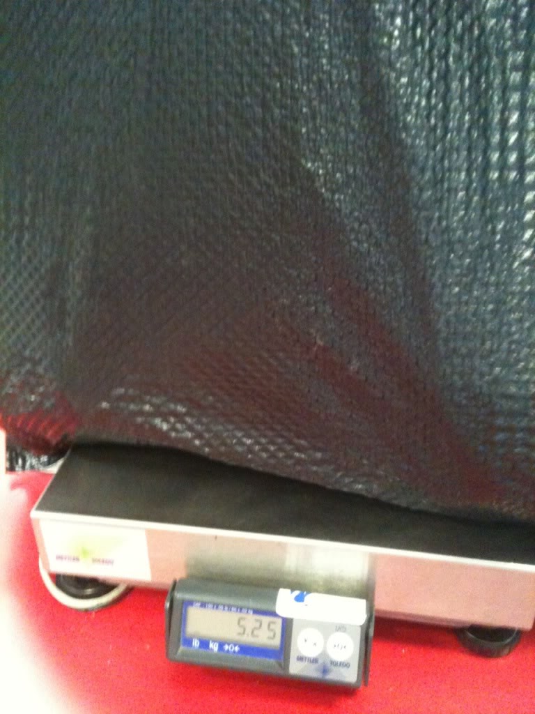

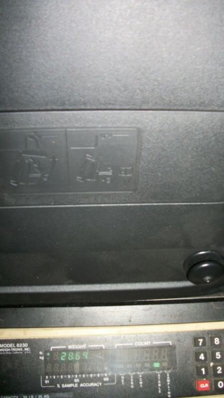

Rear door panel - 5.25 lbs (10.5 lbs for both rear panels)

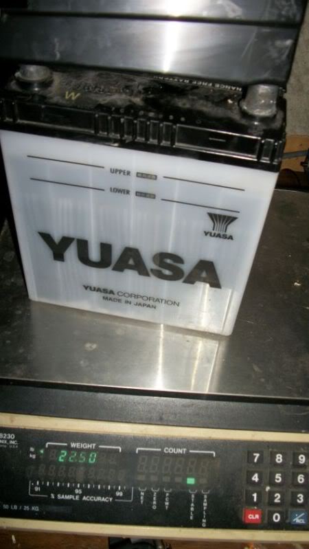

stock battery & cover - 22.5 lbs

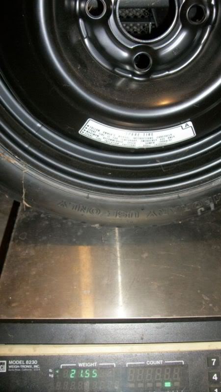

Spare tire - 21.55 lbs

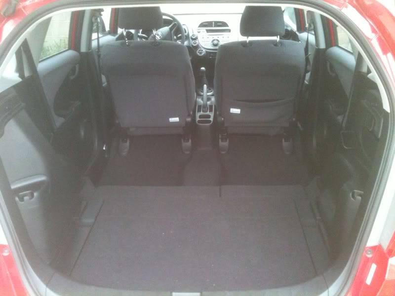

Rear seat (short section), less bolts and belts - 28.69 lbs

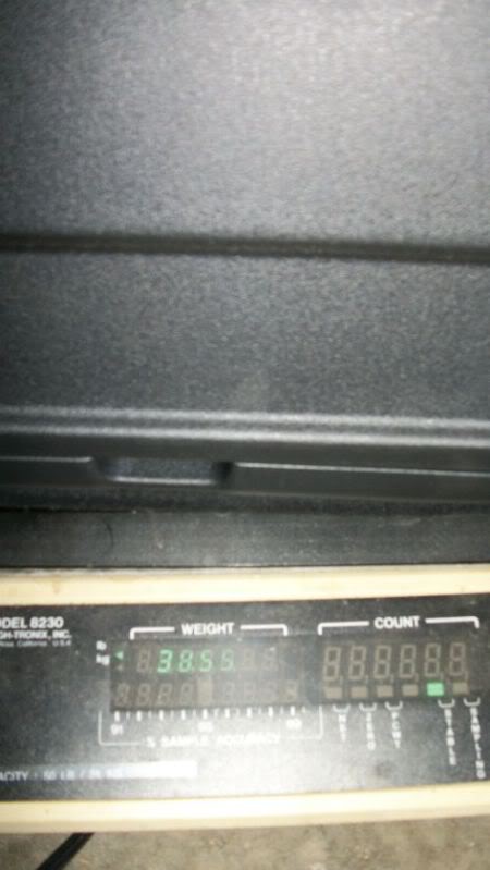

Rear seat (large section), less bolts and belts - 38.55 lbs

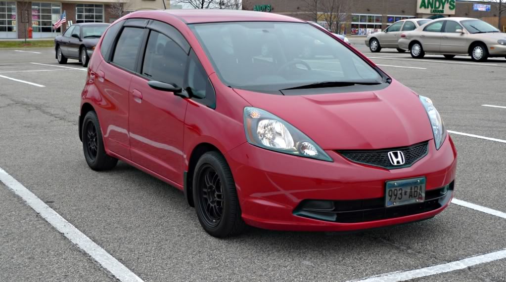

Props to Tork for providing verified weight/pics.
2009 base model.........................2489.00 lbs (Honda quoted)
- Rear seat................................ - 67.24 lbs
- Jack/wrench............................. - 4.55 lbs
- Spare tire............................... - 21.55 lbs
- Steel wheels/dunlops (33.2 lbs). - 132.80 lbs (x4)
- Stock springs.............................- 16.6 lbs
- Stock battery.............................- 22.5 lbs
- Rear seat belt..............................-4.75 lbs
- Rear wiper/motor..........................-3.18 lbs
- Rear door panels..........................-10.5 lbs
- stock air box...............................-5.00 lbs
- stock axle back exhaust...............-11.0 lbs
Weight reduction (gross)...............-299.67 lbs
+ Odyssey PC680 ........................+ 14.45 lbs
+ Enkei RPF1/Toyo Proxes4............+ 98.80 lbs
+ progress springs .......................+ 21.00 lbs
+ PRM SRI...................................+1.8 lbs
Weight reduction (net).................-160 lbs
