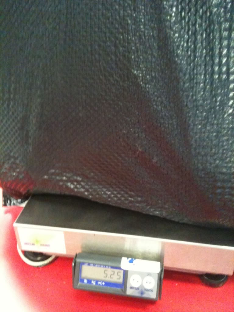

Rear door panel...total for both is 10.5 lbs

Is the door panel in some kind of bag? Need to remove some ounces from the weight if so. hahahaha
Good shite regardless.
looks like glad bag

yeah, all door parts are stowed in separate bags to keep things organized.

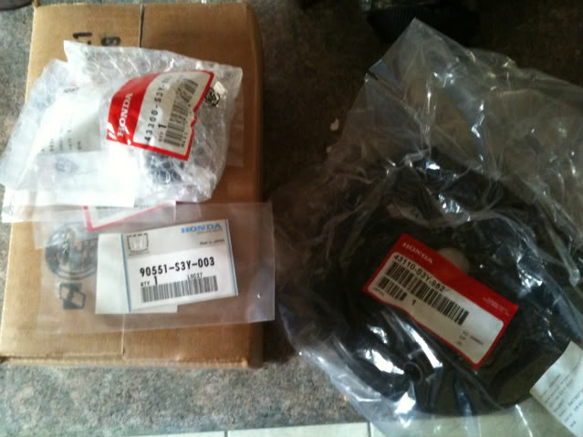

Good news....the Insight rear drum finally shipped. Hopefully will come in early next week. The turnaround time with Bernardi borders on unacceptable. I realize this is probably a hard to find part, but they could have notified me of the delay.

THREE WEEKS LATER:
I called Bernardi customer service about the delay (it would be different if they had notified me of a delay...even that my order was received!?!?!...but no...). I asked for free shipping, or at least upgrade to priority, on my next order....but guess what those f@kkers were willing to offer? 25% off of 5 day ground They offered 25% off of $13.00...$3.25...nothing more! This was a $130.00 order and I was about to place a second $130.00 order with them. WTF?!?!
Never again will I use Bernardi.
/RANT
Hope to get the right side on tonight.

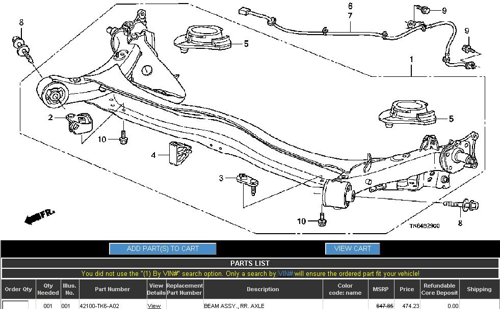

Got a crazy idea to reduce mega-unsprung weight...while I was sizing up the Insight rear drum swap (more on that later), I got the crazy idea of trying to get someone to fabricate an aluminum or titanium complete rear axle. The stock steel beam is HEAVY...but the cost of a custom job would probably be $$$$$$$$$$$$$$$$$$$$.

Any thoughts on the pro's/con's of an aluminum or titanium rear axle? I know corvettes use aluminum rear axles...so it should be fine in our little Fits.

Only problem I see is that the rear end stripped down only has 550 lbs on the rear axle per my last CAT scale weigh in. With a front end that weighs 1520 lbs the weight bias towards the front would be pretty wild. Not sure at what point that begins to impart handling.
