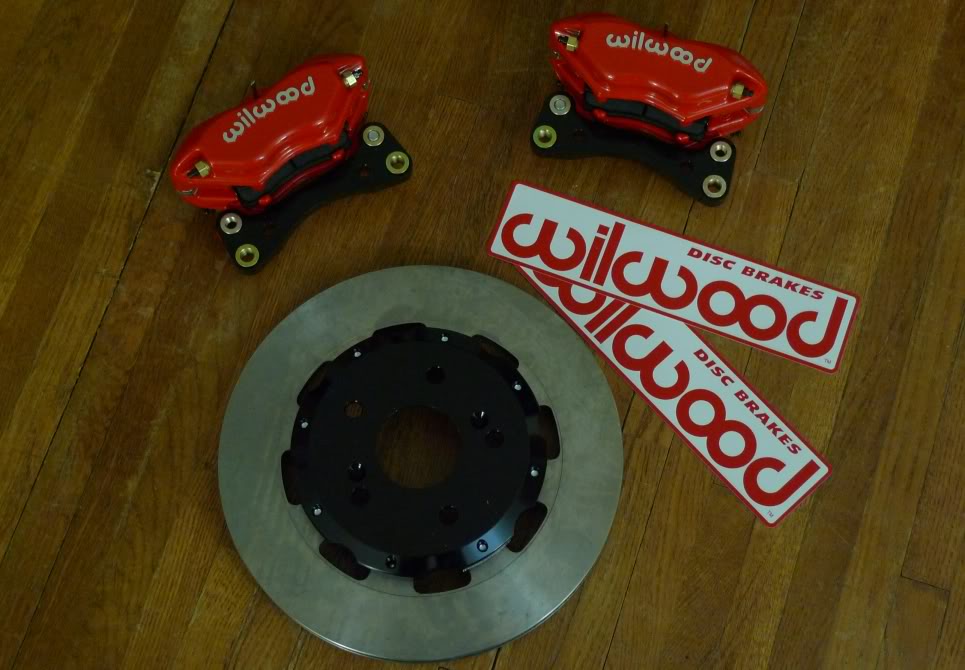

BTW, I did end up getting the Wilwood Dynalite kit front and rears....just not for the fit though:

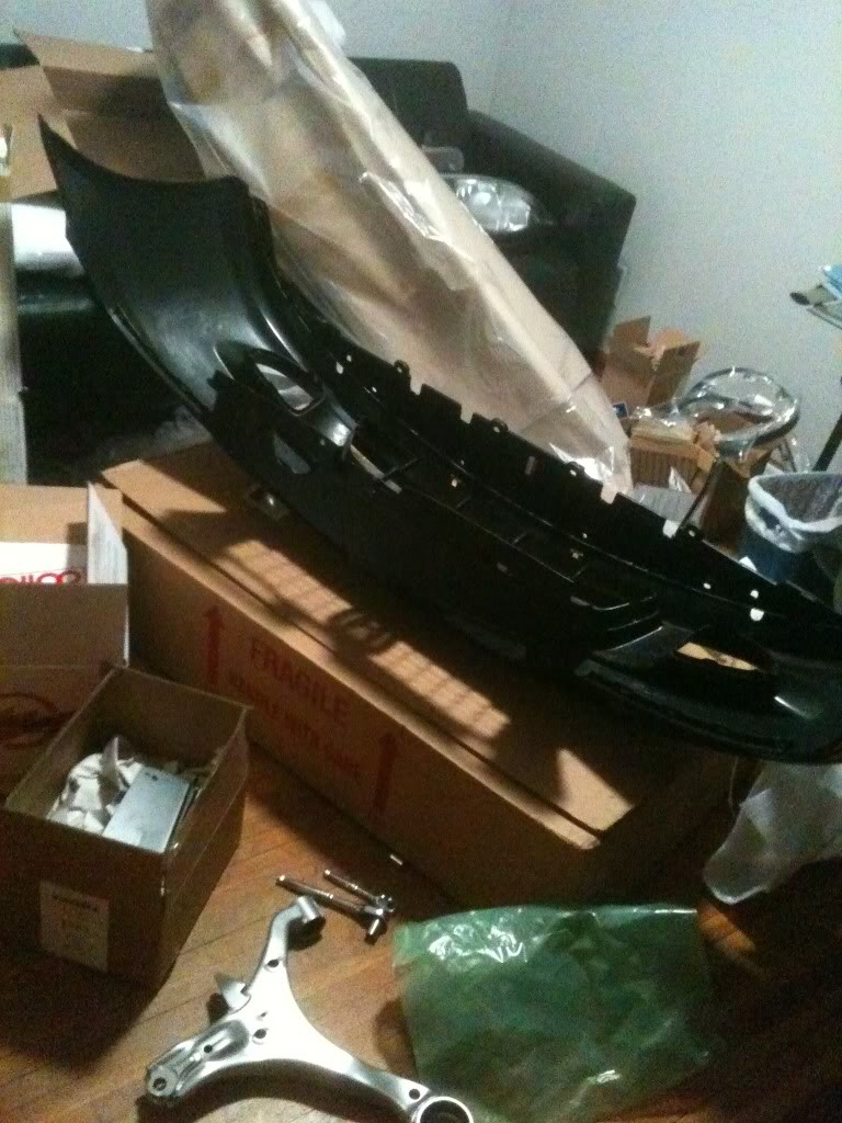

A room full of parts for my K24 swap in progress on my track-duty civic....click the link in my sig below:

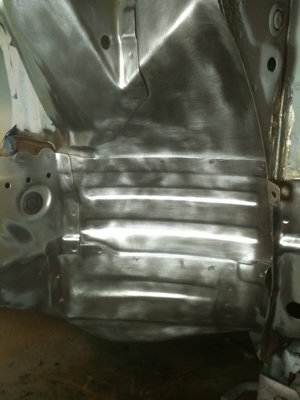

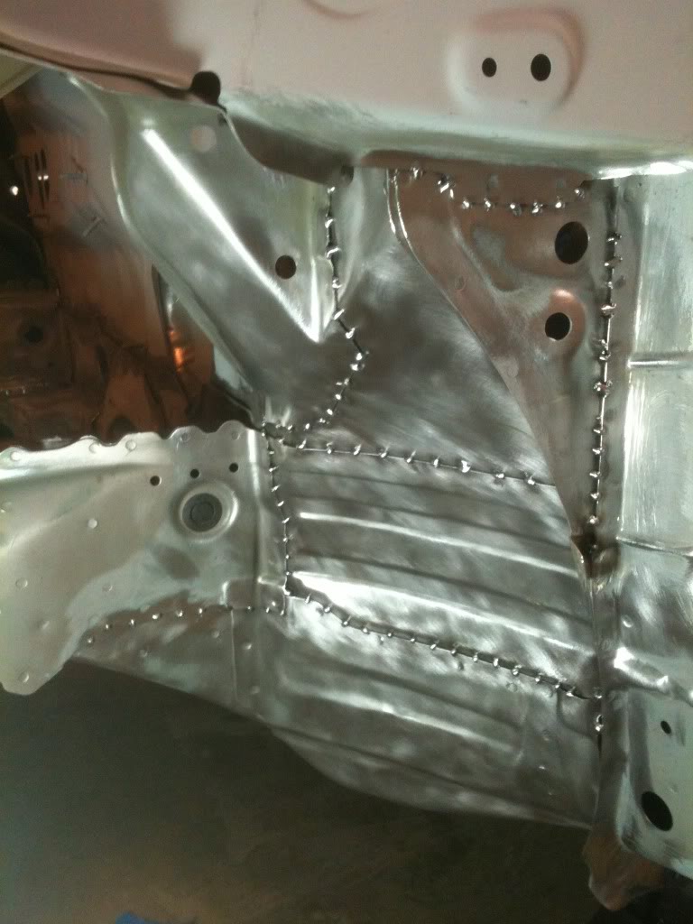

Stitch welding the engine bay and fender wells:
BEFORE:

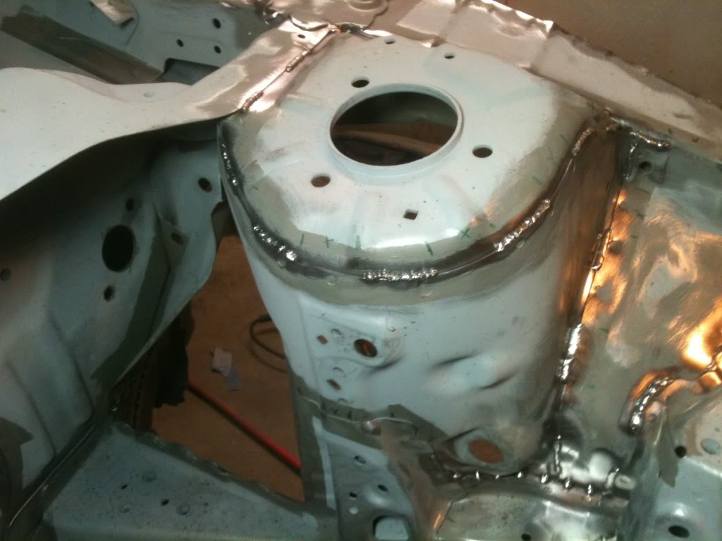

AFTER:
Strut towers:

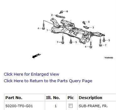

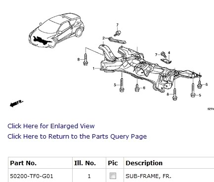

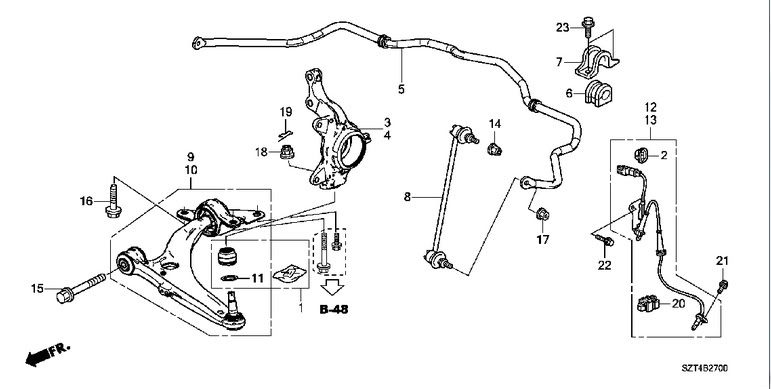

Started contemplating the CRZ front LCA swap. Now that the parts are available online I'm able to compare part numbers.
First off, the front subframe is identical...same part # and everything....
CRZ:
FIT:
And just recently I've been able to find the part # for the aluminum front LCAs from the CRZ...they're $220 each. The only variables will be
1) whether the Fit knuckle will work
2) if the offset is wider, the Fit axles may be too short
Once the snow thaws and I get my Fit out of storage...this will be my new project. Props to 555sexydrive for suggesting this swap.

Unfortunately, the torsion beam sussy is identical between the CRZ and Fit...so no weight savings potential there. It's unfortunate that Honda didn't give the CRZ the same multi-link rear suspension as the TSX and Civic. The upside for Fit owners is that the "tracking/slalom" ability of the CRZ should be identical to that of the Fit....it's the same chassis....and we will benefit from the aftermarket suspension components.
I'm guessing that the Fit might be quicker through the turns b/c of the additional weight of the 5-lug (obviously the IMA + batteries also contribute a significant amount of weight).
Old Jan 23, 2011 | 12:38 AM
  #271
blackndecker's Avatar
Posts: 1,316
Good news, the axles and half-shaft are identical b/w the CRZ and Fit...so the only potential problem bolting the aluminum LCAs would be the knuckle.
