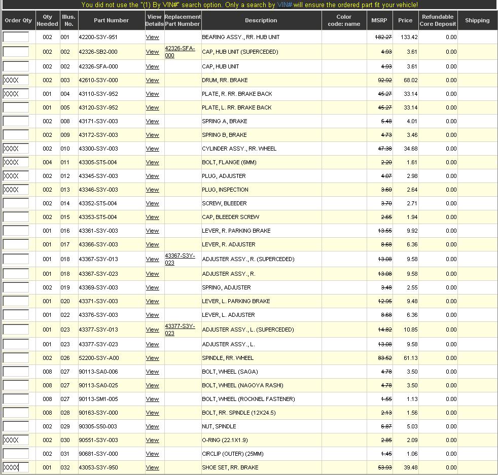

I really hope the Insight drums come in today...
Slow day on the forum so I thought I'd show where I'm at with the Insight drum swap.
I used Bernardiparts.com, for no other reason than because Kitty suggested the site. There are many others you could use...possibly with free shipping or a lower listed price.
Here are the parts that I ordered for ONE (1) complete rear brake...if additional parts are required I will update this list:
After EXTENSIVE research...the only problem I forsee is the wheel cylinder assembly (see pic below) appears to be a different size between the Fit (3/4) and the insight (11/16). I cannot confirm this information...I had two different dealerships contact Honda Technical support and they would not release, or did not know, the answer. The implication of this is that it **might** change the brake bias. The difference between the two is so small that I doubt this will be of any significance...however, if necessary, Summit Racing sells a brake bias adjustor for about $100.
This is the wheel cylinder assembly:
The total is $184.64 before shipping...this is considerably cheaper than a disc brake conversion. At this point, I don't know which would provide the greatest weight advantage (Insight aluminum drum vs. aluminum caliper/hat/steel rotor setup).
Hopefully the parts come in and I can get the right side mounted up this weekend.

BTW, screw Bernardi....they take FOREVER to get crap delivered. Maybe it's just my location and their warehouse, but I will never order from them again.

Sh!t. I feel like this is kinda my fault. Sorry for recommending a lame-azz parts provider. At least we can use their diagrams to figure out what to order from someplace else.
You're insight rear drum plan is like crack rock to me right now. C'mon bernardi, send the freaking parts already! I want to see progress!
