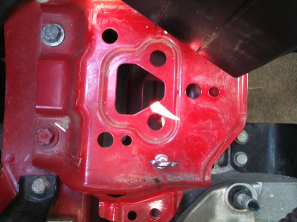

When you take out the old battery, tie down, and plastic tray...this is what is left. Basically a ledge mounted to the frame. I also mounted an eye bolt (seen at the lower edge) to anchor a bungee strap.

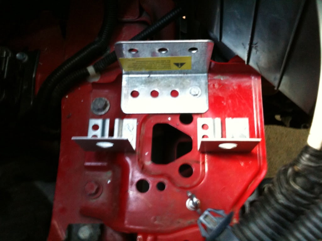

I found some "L shape" metal bits around the house that I bolted in place to secure the battery. The larger one was lying around in the garage...I think it's part of the original electric garage door opener. The other two pieces are from a platform bed I bought at Ikea...but never used these mounts. Lucky I saved all these pieces.

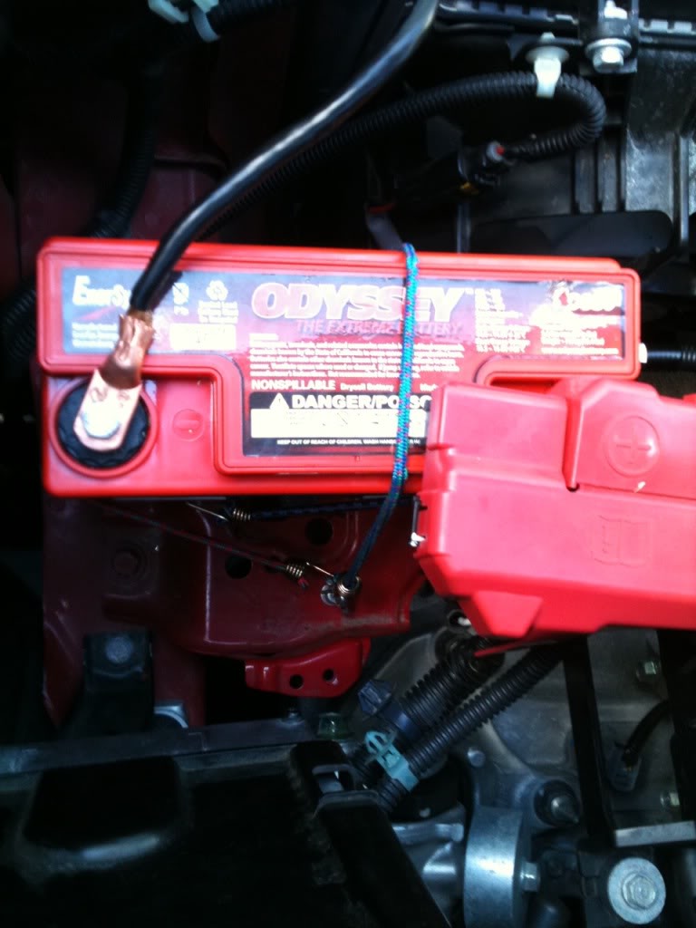

Once everything is bolted in place, I wired the battery up....I used bungee cords until I can fabricate a metal tie down to go across the top.

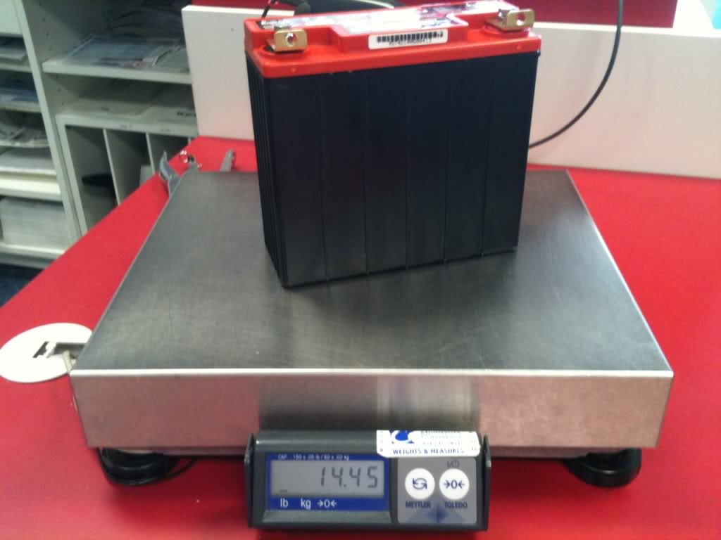

I was pretty stoked to see the odyssey battery weighed even less than the manufacturer's estimate of 15.5 lbs

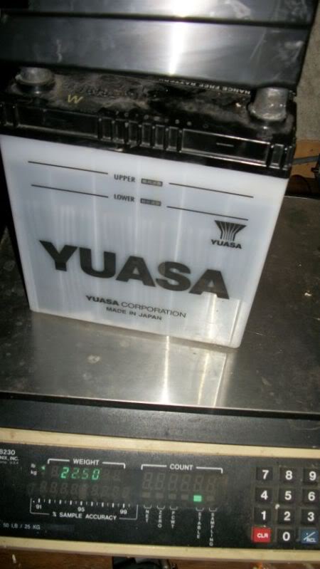

Compared to the stocker...

Total weight savings was around 9 lbs...including all the mounting hardware for the stock battery. It was a very good day....
