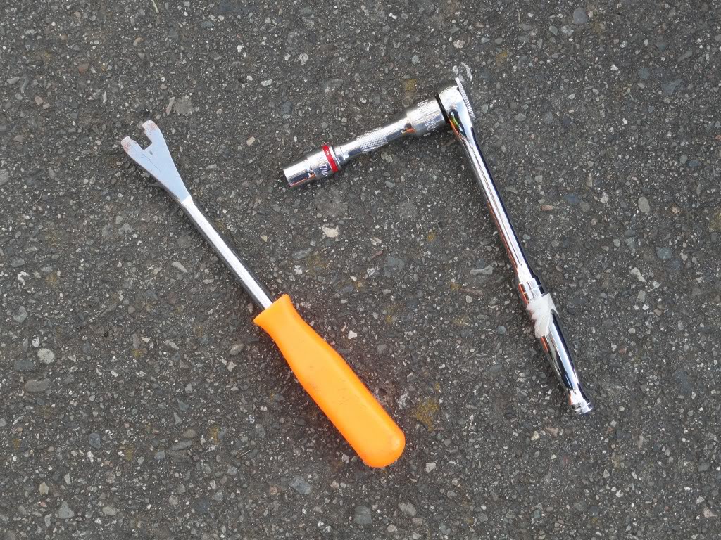

1. Get all the tools needed. There are not many I just used a panel removal tool and a 10mm socket. The panel removal tool will prevent you from scratching anything while you're working.

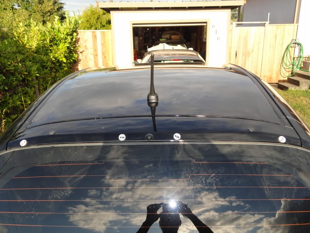

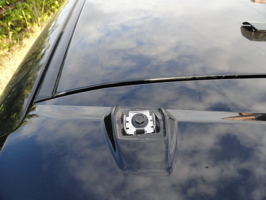

3. Once the spoiler bolt cover pieces are removed you should see this. Now take your 10mm socket and remove the two bolts. You don't really have to worry about the spoiler falling it's on there pretty good.

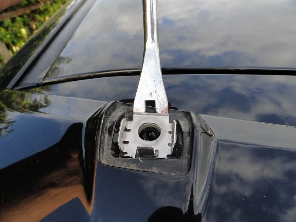

4. After you get the bolts removed then you can remove the little aluminum brackets that the bolt covers snap into.

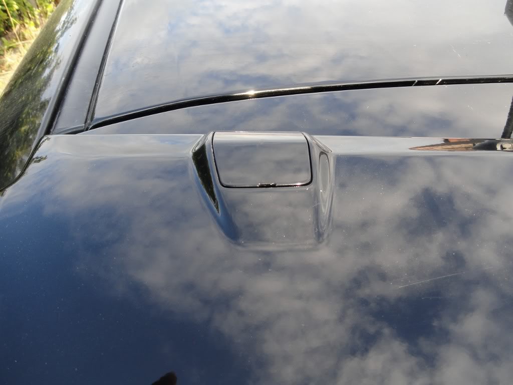

5. Now you can evenly apply pulling force to the entire rear spoiler. the spoiler has a few clips so you will feel some resistance but just keep pulling evenly and relatively straight back and the spoiler should come off.
Once you have it off it should look like this.

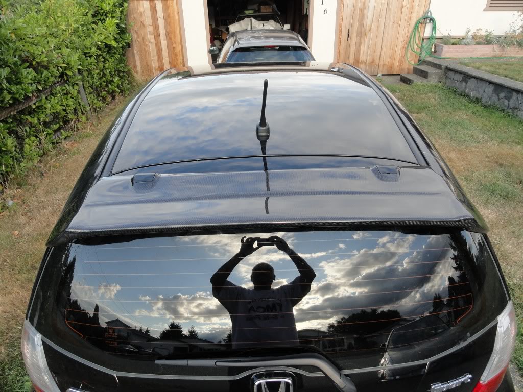

7. Mount your new JDP rear spoiler and secure the bolts. There is no need to go all Incredible Hulk on the bolts just enough torque so the spoiler doesn't wiggle. pop the bolt covers back on and you're done

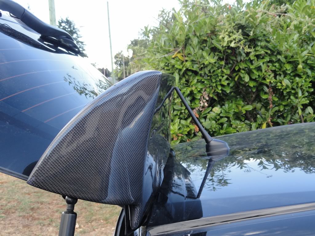

Antennae clearance:
