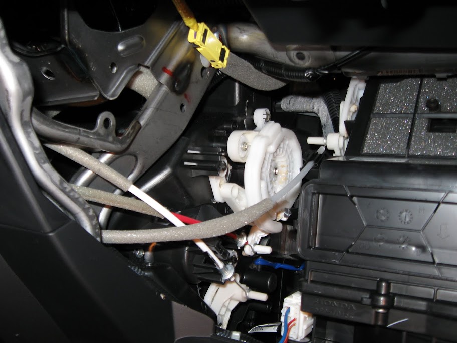

With the lower glove box open, press inward on the sides to allow the rubber stops to clear the opening. The glove box will continue opening towards you until it flops down (might be a good idea to empty it of all your dad's unmentionables first).
Move the recirc lever back and forth. You can watch the movement of the flapper and maybe see if anything is blocking it.
Behind the glovebox is the filter/recirc assembly. The filter pulls out towards you (just press on the tabs). Might want to have a new filter handy (they're about $25 at Honda parts).
If there is a nest in there, you may want to have a vacuum with a narrow wand attachment handy. Below the filter is the heater/AC blower wheel, you might have to vacuum crap out of it...
Here's a pic of what it looks like after the glove box is pulled towards you (filter "drawer" and the flapper above it are to the left of the pic):
Another pic looking to the left. The mess of cables can be seen to control various A/C/Heat functions.
