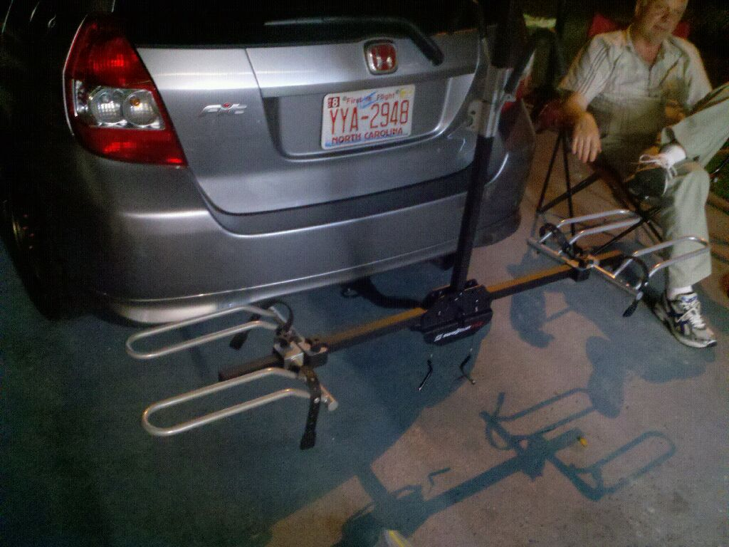

Rack and hitch installed last night.
I really like how this bike rack works. Very easy and very secure. Once I assemble my bike I'll get some better pics with it mounted.
