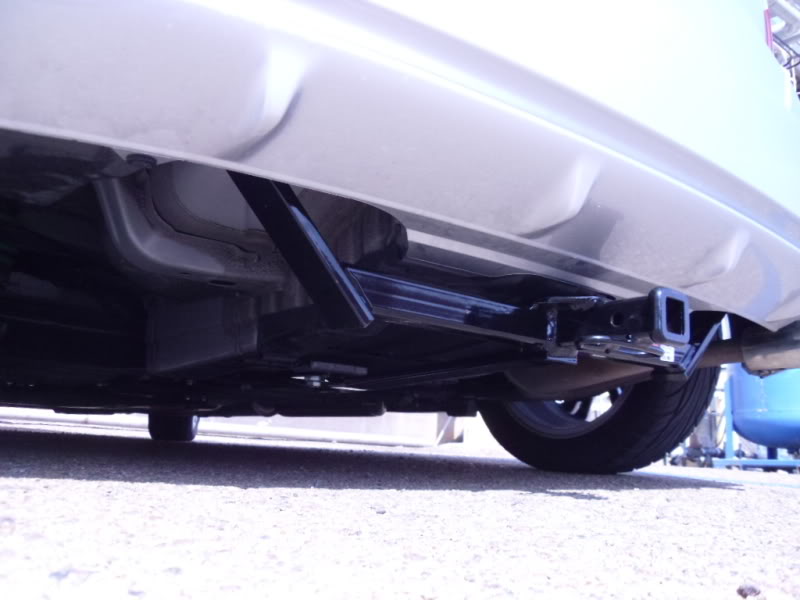

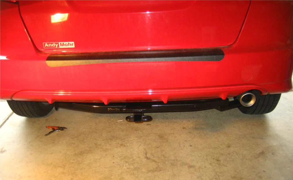

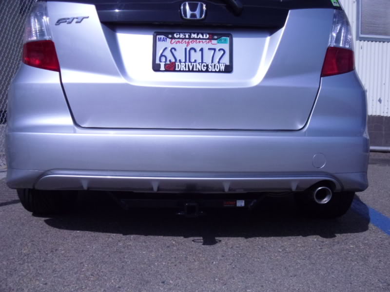

I went with the Curt setup. I liked the idea of a 3 point attachment and not having the hitch go under the exhaust. I had to drill a single hole in the driver-side rail, but was super easy. Install took me about 35 minutes including running the wiring harness.
