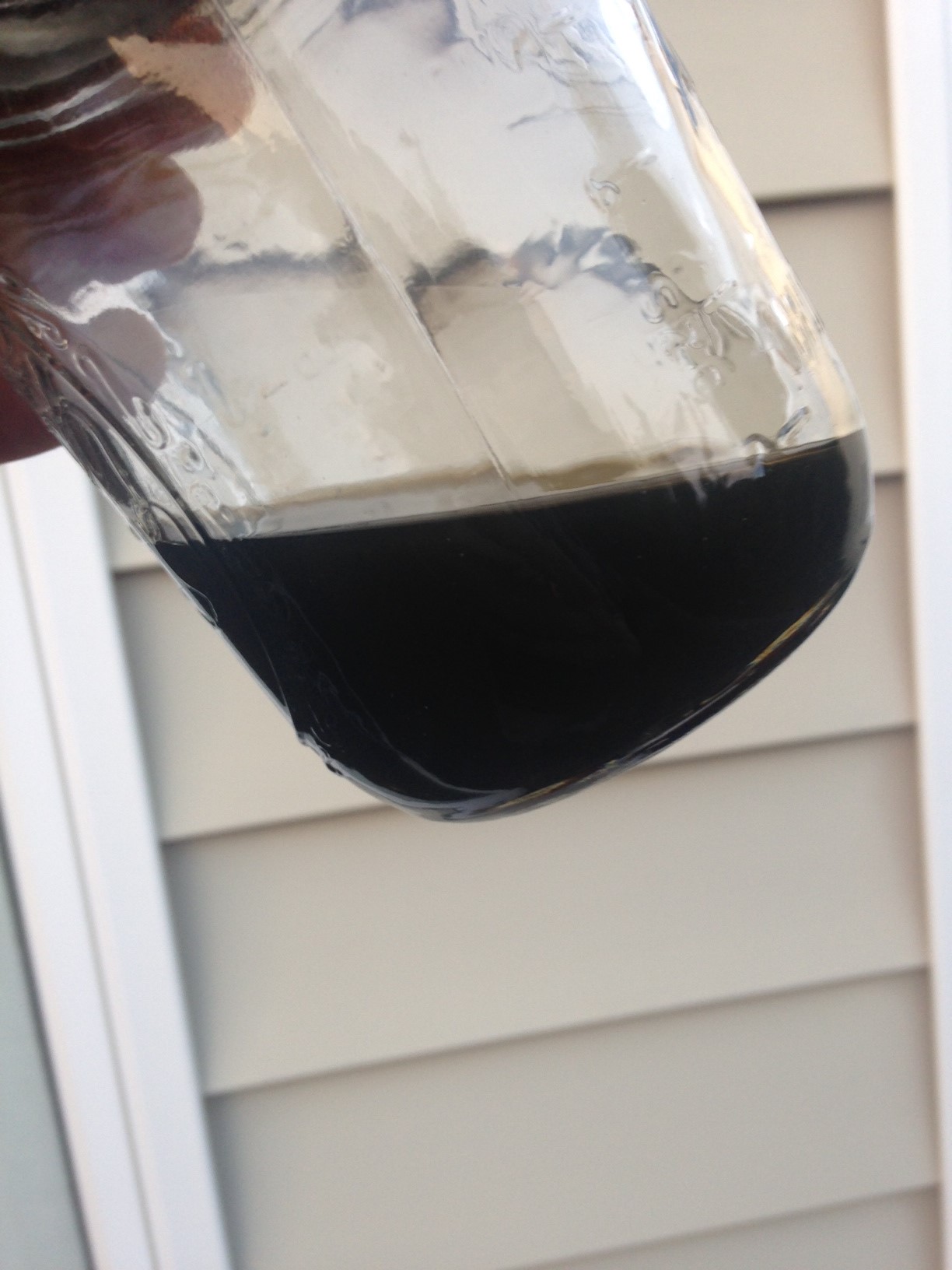

Hi folks - long time lurker, first time poster. I was hoping you could help me with a (potential) issue. 2012 manual tranny.
Background: I took my Fit in for service around 15k miles to address a minor transmission rattling noise. The tech said he drained the oil which was "jet black" and said that was an indication of premature wear. Two days later he changed what I believe were some internal transmission gears and sent me on my way.
Now 45k miles later I'm almost hitting my 60k drivetrain warranty expiration. I decided to take another sample to make sure everything was fine, and low and behold the oil is almost the same color black. Picture attached.
My question: is manual transmission oil supposed to be this color after 45k miles of service? I'm trying to decide if I need to take it back in for service before my warranty expires.
Thanks in advance!

It would be wise to take it to Honda for their comments and have it documented should they chose not to do anything now and you have problems after wty expires.

first of all, you went 45k miles with no fluid change. that is a no no
second, my fluid at 30k miles looked mildly dirty compared to the fresh fluid that went in. Im changing my fluid every 20k after that initial 30k
go online and buy a magnetic transmission drain plug. double check thread size, but I think civic ones will fit, as they have a bigger aftermarket and easier to source
EDIT might want to check and see if the breather on top is getting lots of dirt in it. I dont know exactly where it is, you can check an online parts dealership website

I ended up changing the MTF this morning in my garage. The remaining MTF that I drained from the car didn't look as bad as the sample I pulled last night...maybe that was because the car was hot from a round trip to/from the local dealership.
So short of doing an UOA on the sample I still have there may be nothing more to do at the moment. For sure the car shifts a hellava lot smoother which would be expected.

Results speak for themselves. If the fluid change fixed the problem then it logically implies there was something wrong with the old fluid- at least for this particular car and this particular driver.
But check to see if this is just the initial breakin for the fluid as it heats up for the first time. See if the results are still there after 500miles before concluding.
