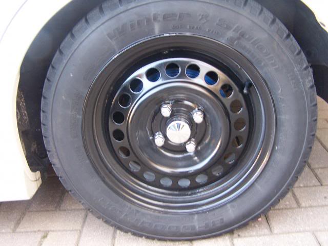

Here you go.
https://www.fitfreak.net/forums/gene...er-caps-3.html
A pic of my winter setup using these caps and my Sp
ort nuts.

Thanks for your help Black3sr. I am actually looking for the OE Honda caps with the H on them. I think they fit the rims for some older Civics.

I went the Honda caps first as well. Finally found some. First winter was ok but next Year two of them fell off. They were pricey as well.
If you want H logo you can find vinyl ones to put on the silver caps.

i agree with blackser. those oem caps from old school hondas are very pricey. best bet is to go with the chrome caps like me and blackser. or hit up your local junkyard and see if u can find some decent ones. u can find used ones ebay but they are like 20-50 bucks each.

Nice look to go with those. If you're sticking with open-face black steelies, the paint on them can be a bit thin in places. I did mine on both sides with Rustoleum gloss black, after thoroughly cleaning brake dust etc off using de-glossing cleaner (Home Depot paint dept $6) and rags. 2 coats of paint later and some new chrome lugs (be sure to use ball seat taper lugs for steelies) and they look better than factory, even under the pie plates. Plus any brake dust doesn't stick much and rinses away easily at bath time.
