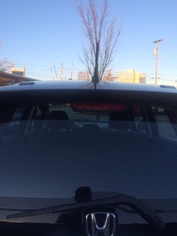

Hey everyone!
I just purchased a 2013 Fit Sport, and it's great so far. There's one issue, however. Does anyone know how to reset the resting position of the rear wiper? Right now it's sitting below the rear window. Do I just unbolt the rear wiper, or do I have to go in through the hatch and adjust something?
Thanks!

I just had my 07 hatch apart, I saw nothing on the motor that was adjustable so I'd assume its the arm needs loosened and turned.

Fixed! Just took off the wiper with a socket and reattached in the proper position.
