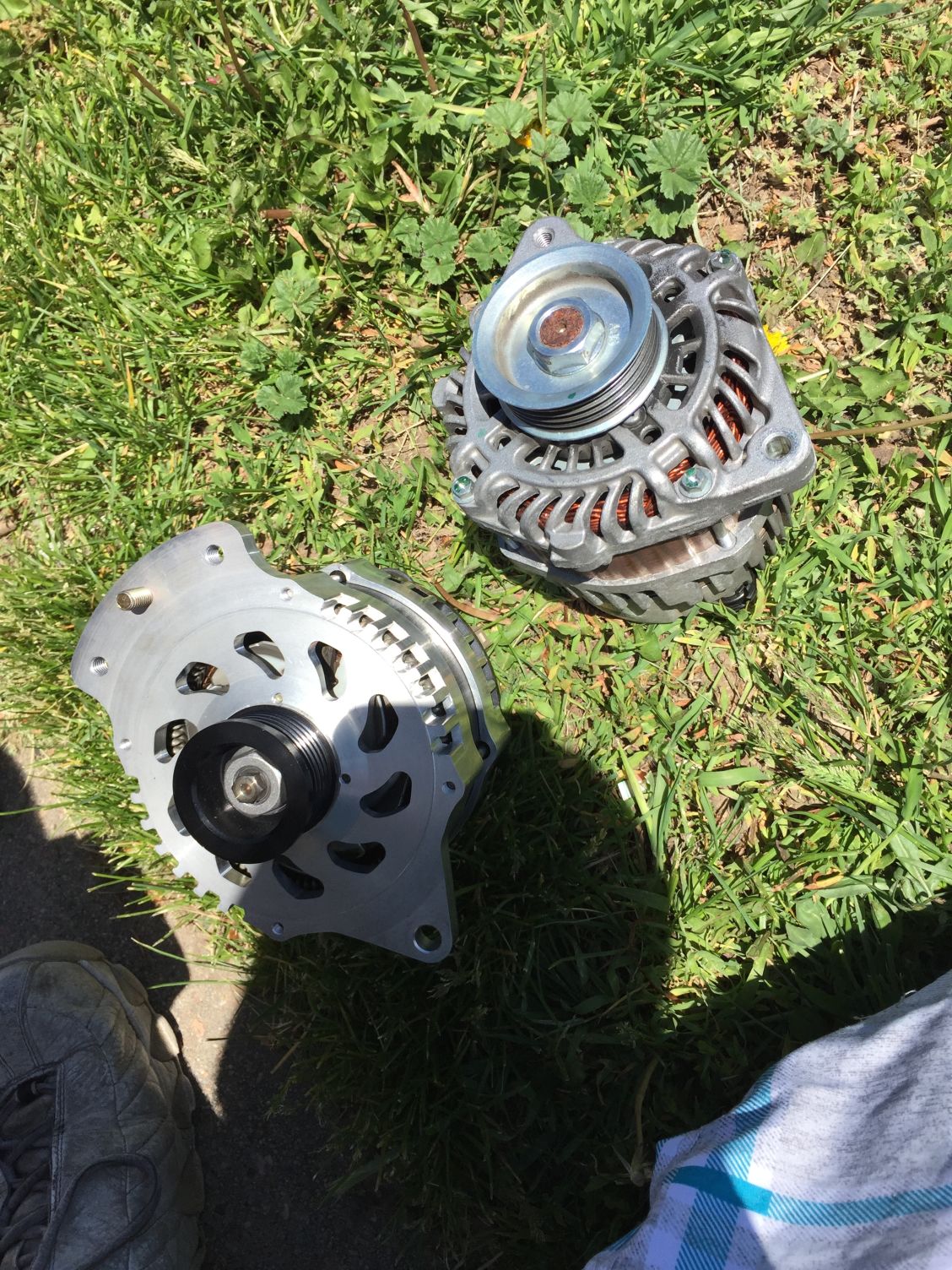

Old and new side by side

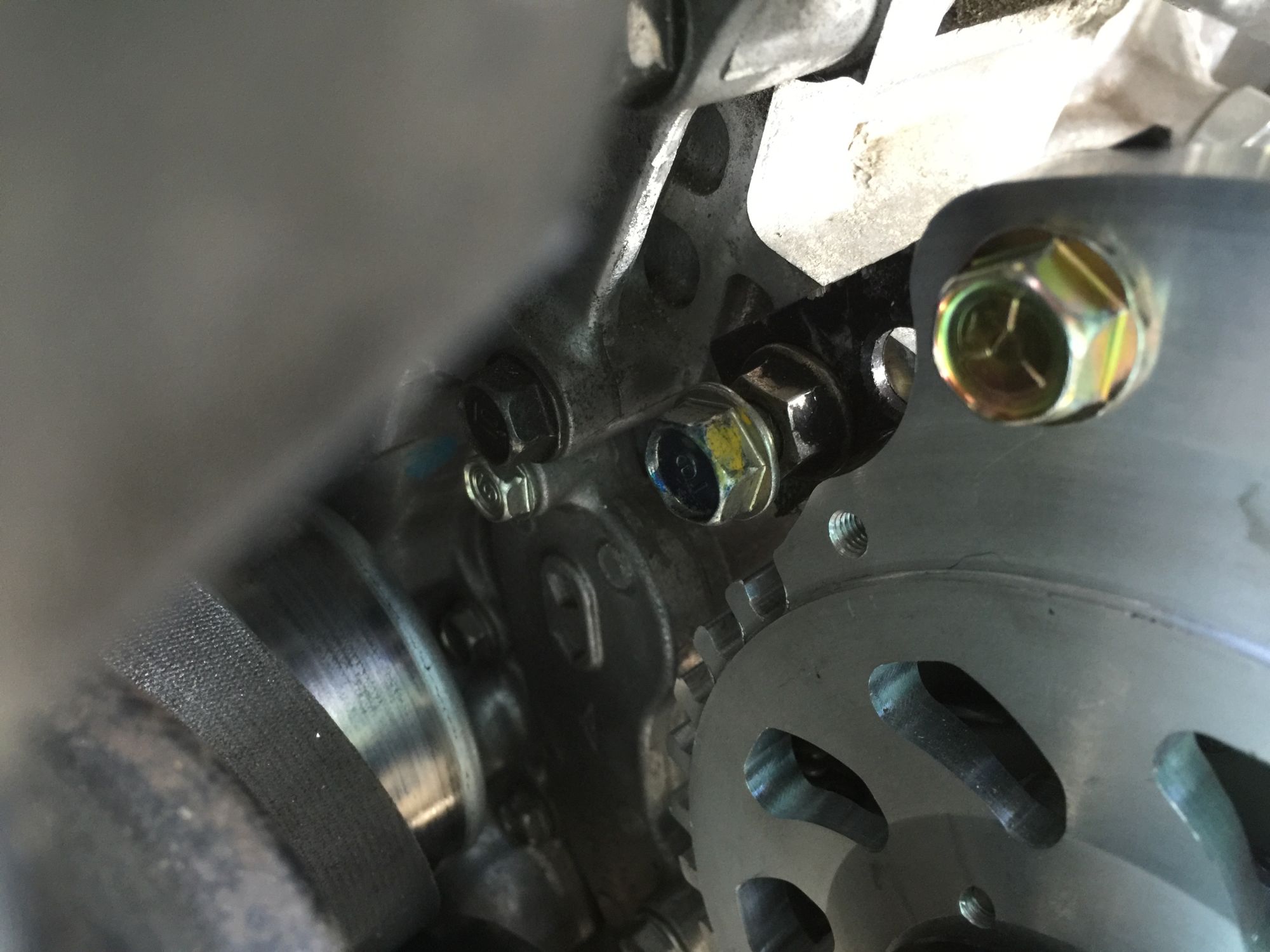

Had to put a nut on factory bolt to shorten it, eventually I will get the right size, I just want to get a forged high temp automotive grade bolt first.
The foot bolt I had to use spacers on and had very little to work with because the pulley was right there

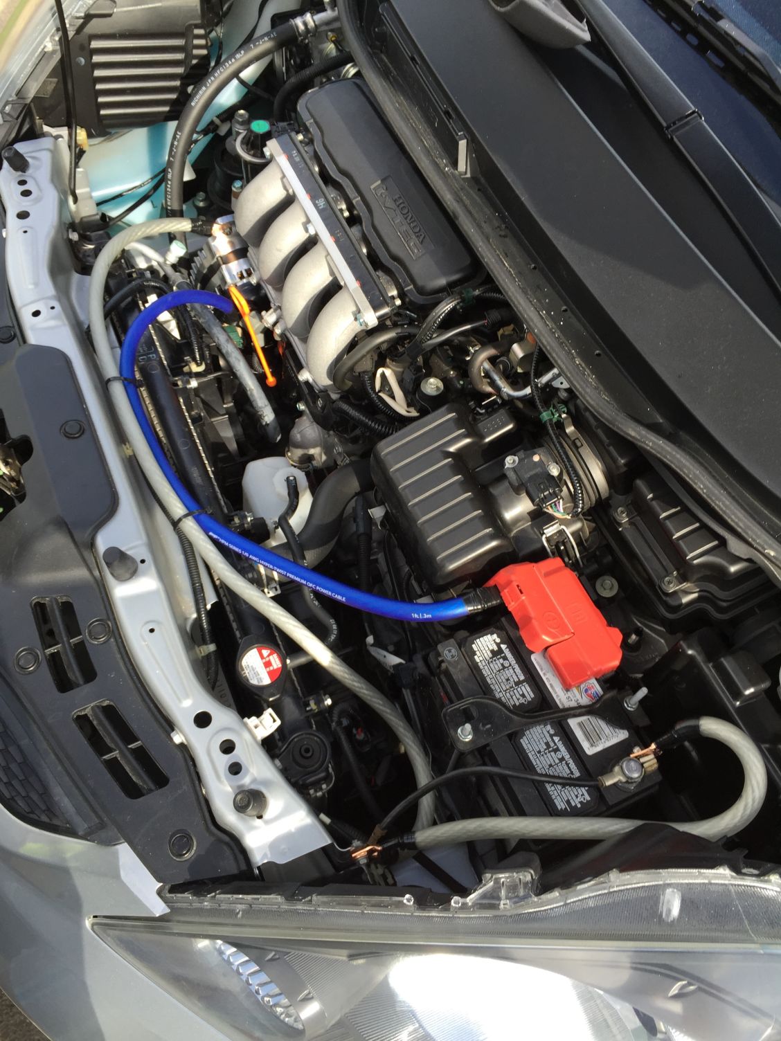

Did the big 3

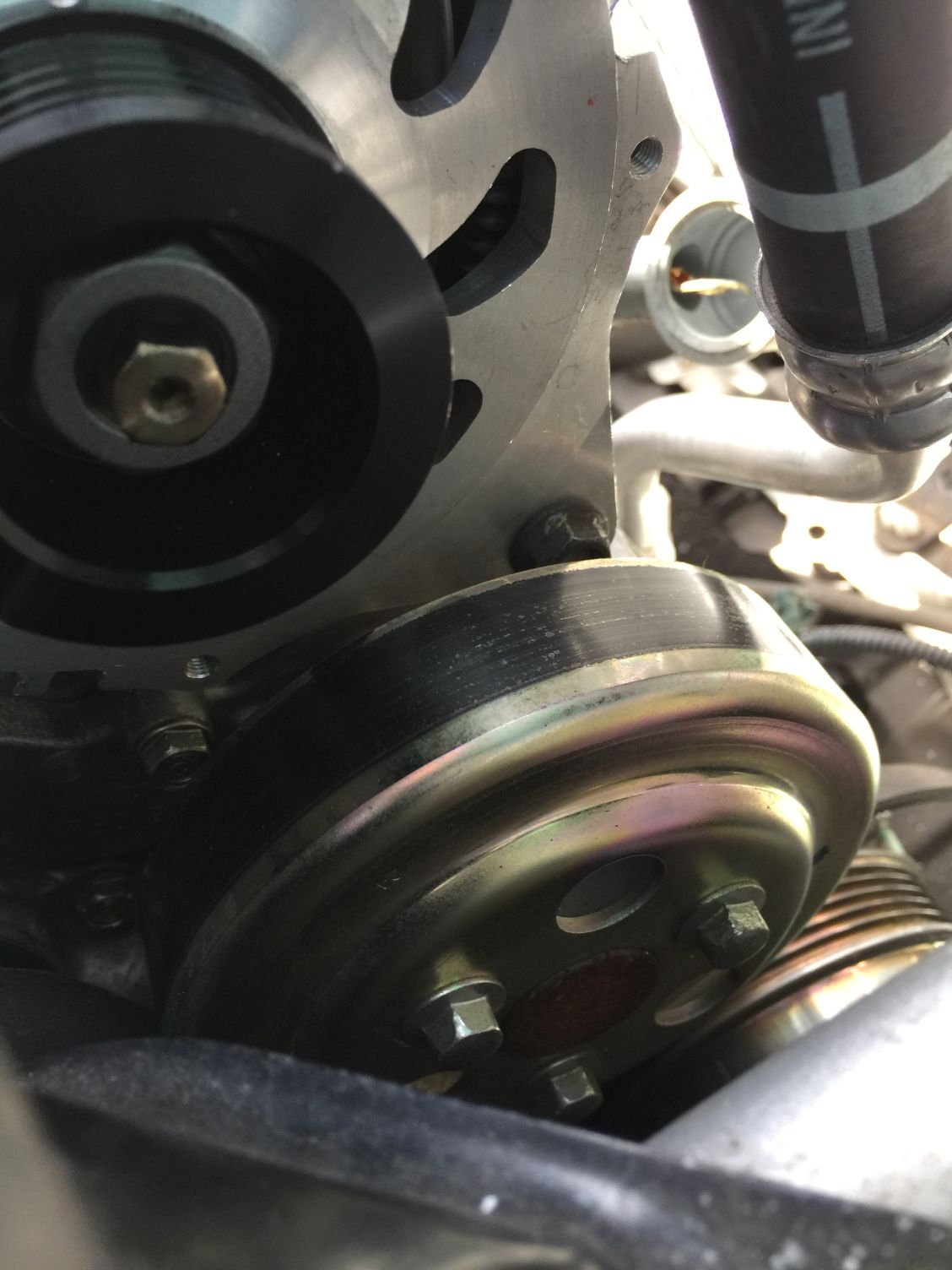

Just enough room for new one
The problem I am having is it changed the geometry of the belt system. The new pulley is a bit smaller. When I took the belt off the factory belt was a horror to get off. The new alt the stock belt went on easy, the tensioner is now almost to its bottom. When I start the car the tensioner rattles a tiny bit and also at idle when ac kicks on.
I went and got the next size belt smaller. The factory belt is 45.3"OC (outer circumference the new one is 44.3"OC. I had to hunt 5 diffrent places to get this belt.
The issue I'm having is I can't get the new belt on. It's too tight. I can tell it's the right one based on how hard it was to get the factory belt off the stock alt. I used a piece of 4ga wire to lift tensioner just like a previous write up on this form member did.
Is there a specific way to install the belt? Seems even with tensioner all way loosen its still a bitch to get on. Even the factory belt with factory alt.
Do I have to get the tensioner tool? Or is pulling up on the tensioner a bad idea?
Did the big 3
Did the big 3
Did the big 3

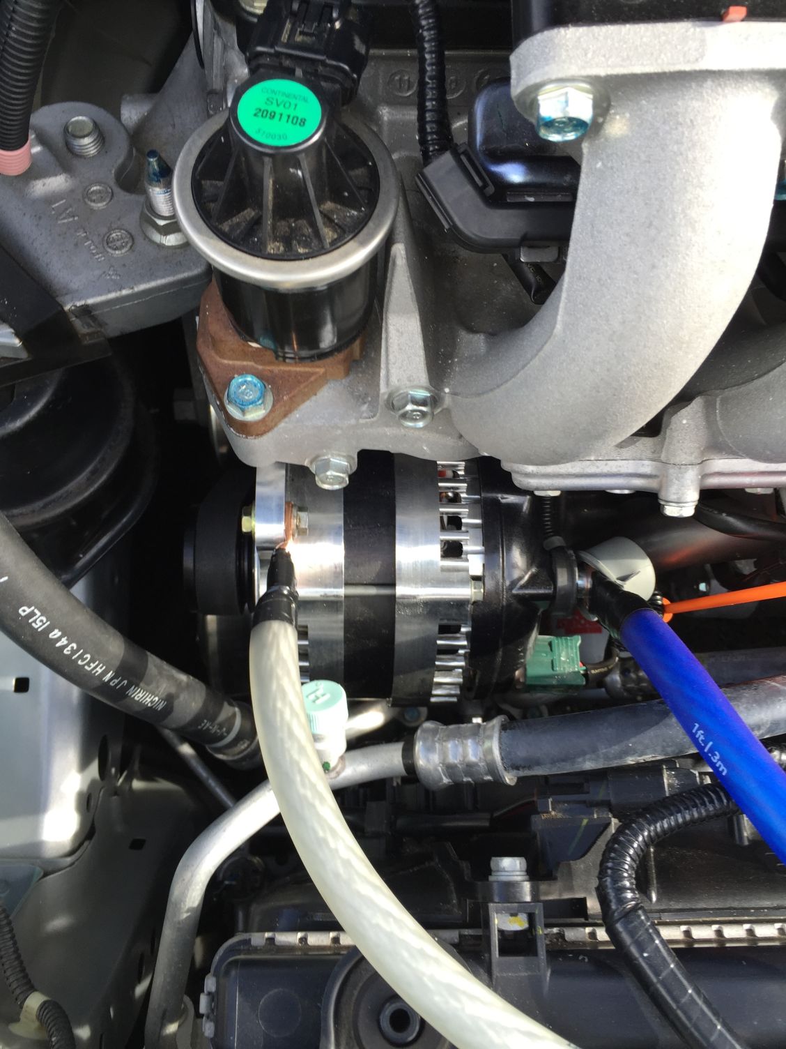

It's internally regulated, they made it with stock Honda regulator and pcm codes
I did the eld work around
Here's my thread, reason being I want the engine management to work the right way,
That way all of my sensors aren't in a limp mode you don't want That.
Sure you can cut the control wire at the alternator plug or go externally regulated the battery light will stay off only because there's power at the terminal . But electrically the cars computer will have an issue the ELD work around actually makes the regulator do all the controlling of current . Except in a few conditions the alternator will turn down like during hard acceleration , to about 85 to 90% of the time the regulator works normally it's worth the extra work 100% to do it this way I have 4500 W five amplifiers and I have zero problems with three tiny XS power XP 750 batteries that are the size of a motorcycle battery .
I'm going to take out the two small batteries I have under the hood and put a group 34 in there and leave the one little powerpack battery in the back . I could easily get away with just one really good battery under the hood and the alternator and that's it .
I have more detailed instructions if you do go with that same exact alternator from quality power if you would like or you can get one and try it on your own. The nice thing about this one is it's dual rectifier which essentially puts 12 diode at the output instead of only six . It comes in the 250 amp or higher version . I wish I would've spent the money and got the 300 or 350 amp in hindsight, at idle I have 160 A , So I'm not that mad .
If you need anymore help let me know doing it this way was definitely the right way to do it .

A replacement stock size belt was a perfect fit, the stock belt , the one I took off was stretched because how tight it fits on the pulley system so I got a brand-new one and it was perfect the stock when I took off worked but it made the belt tensioner bottom out and run out of travel because it was so loose so I just re bought the stock size belt and put it on and it was perfect , yes I tried a smaller one and I couldn't get it on .
