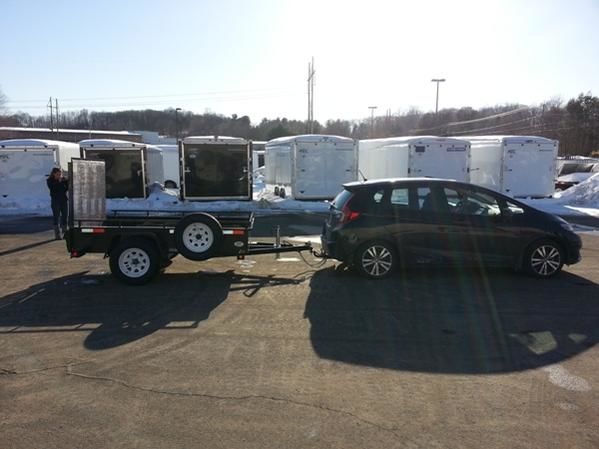

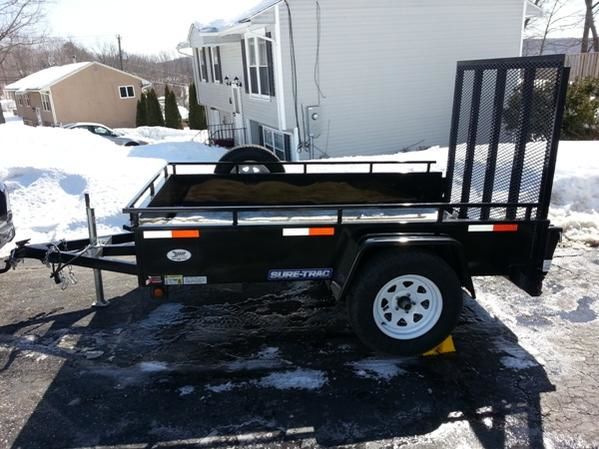

Potentially yes. LEDs draw way less power. Powered converters are the best tool for such an application. The wire gauge for the lights in the Fits are so thin, like 22AWG that any extra load would overload the wire itself and the circuit feeding it. Its a cheap converter, and limits you to running only LED lights. Should you haul a trailer with incandescents, which is possible, you will run into problems.
I have LEDS stock on my Sure Trac 5x8. I still got a powered converter anyway because I've seen electrical issues like yours cause major pain points, and possible permanent damage with expensive repair. Whats the axiom, "buy once, cry once."
Sure Trac 5x8 Trailer 02
Sure Trac 5x8 Trailer 01
Tailgating Party with Trailer.
