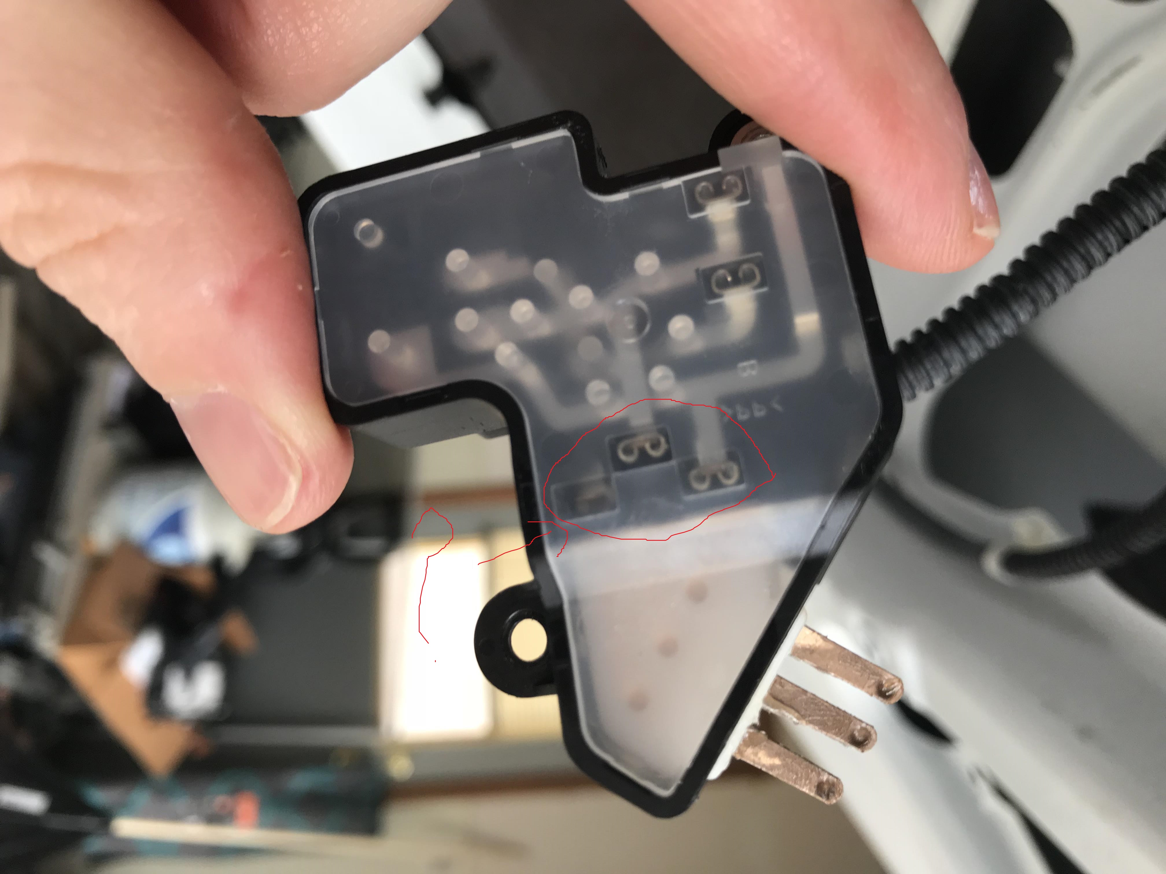

Hey guys,
Had to replace my hatch handle and motor a few days ago due to rust, all that works great now.
Went to put my wiper back on and it goes all the time even when "off"
Any ideas what could be causing this?
I included a pic of what I think could be the problem, am I missing a connector here? Notice there is also no lead to where the missing connector might be..so not sure if that is the problem Anyone able to take a peek at their's? WOuld take less than 5 minutes to take a peek

Assuming that is a relay, I think you are headed in the right direction
It's attached to the rear wiper motor and has one of the plugs that goes into it

Looks like just the one connector
